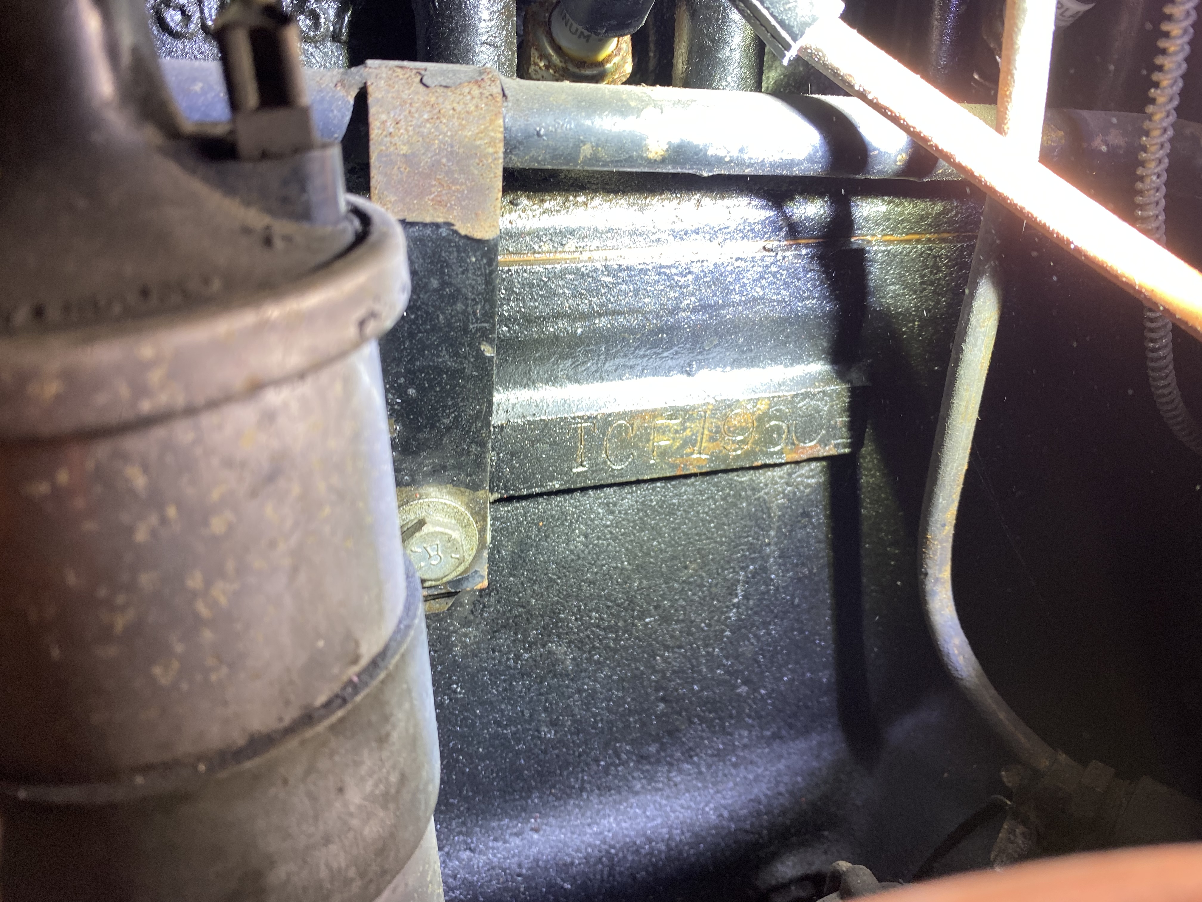

A little help please. I once saw a thread here on how to identify the engine blocks serial number. Want to ensure it is a true TR3 engine. The block is stamped with:
ICF1960E. I do know the E stands for engine. I also have the commission plate as well. Any assistance would be a great help

Likely that first character is "T" rather than "I," so the engine number is TCF1960E, making it (as built) a 2.2L TR-3B engine. If your commission number also begins with TCF, then you do in fact have a "later" TR3B (actually built in the 1962 calendar year and often ultimately titled as 1963 models).
Probably a 1958 motor
The block is NOT likely a 1958 motor. I agree with Andy that the block is likely ( if the TCF is correct) from a 1962 TR3B. One additional identifying point is to locate a number on the cylinder head located on the passenger side near the front . That number should be about six digits and have 55----. Early heads did not have any numbers there that I know of.
But as these engines have interchangeable parts you could still have an early head on the later block.

I’m 99 percent sure it’s not the original engine to the car. Was hoping it was but too many questions. Now it does have the overdrive and i am just starting to look into whether the 1960 models came with that option.
There's no doubt in my mind that TCF1960E is not the original engine. As to overdrive, that was available as an option from the very first TR2s; note the the earliest cars had OD only on top gear. Your commission number ending in "LO" establishes for certain that the car was equipped with overdrive when first built.

Yes they did. But with the different engine block , you may also have a different transmission. That may be good for you. The trannyi that came behind that TR3B engine block had synchromesh between first and second gears. The early transmission did not.

Thank you Andrew. My conclusion as well.
