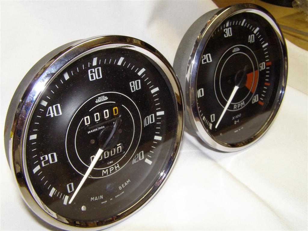

I assume you know that the glass can be easily swapped to get the curved face. I didn't see where you said what your speedo was but the difference between 1180 ans 1184 is trivial I think -- tire selection, claibration and age of the hair spring will have more effect than that.
The one other difference I think I have seen is whether the red line is a line or a red wedge for the excessive RPM range.
Mine look like the bottom gauges.

TexasKnucklehead,
Thanks for pointing out the different location for the MPH/RPM text! Couple of questions about your pictures though. Why do you have pictures of the same(?) TR3 dash with TR3 and TR4/TR4A guages?
Second, my TR3 has the tachometer on the left and the speedometer on thr right which is the same as my TR4A's. Are yours swapped for a reason?

Well...
I got some TR4 guages with curved faces and put them in my dash, then I found out they weren't right. So I went to great lengths to correct that -or at least make it look 'better'. When I got the car, the tach was on the right. Here's pictures of when I got it. The ammeter is scarry and proves the car's story -it floated out of it's garage during a 20' storm surge during hurricane Katrin.
