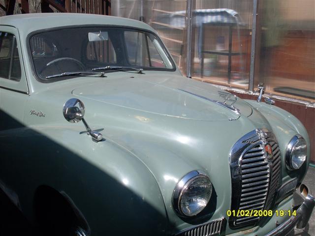

My husband is about to begin a restoration of this 1954 Austin Somerset. It appears to have a small oil leak from the O ring seal. He is looking into an oil filter adapter, and whether it should/ could be used on this car. I saw one on Ebay in the Uk, but am looking for something in the US. Thanks in advance for any advice. (Bear with the time stamp, it's wrong).

I am not sure but I think that engine parts for the '54 A40 is the same as that for the '54 Morris Minor (which is FAR more plentiful in this country). I think that this would be the "flathead" engine and not the one in the later Morris/Sprite/MG Midget (I think) so be wary of that.
Moss should have the parts you need but as Morris Minor parts.
BillM
--if someone knows that I am wrong PLEASE correct this--
Bill
Bill, I just did a bit of Googling and it looks like the A40 Somerset used the first incarnation of the B-series engine (1200cc).
https://www.austinmemories.com/page8/page1/page1.html
This would make it more in common with the MGA/MGB. Really don't know how much is compatible, though.
Grannieannie -- you might want to contact Moss Motors (https://www.mossmotors.com) directly and see if they can help. They're generally quite knowledgeable and may be able to steer you properly.
Yes- I think that you are right. It appears to be the same engine as in the Nash Metro (1200cc) and is just a small-bore/stroke version of the engine in the MGA/MGB so those are the parts that should fit.
BillM

As others have said, this overhead valve, 1200cc engine is an early version of the BMC "B series" engine (used in MGBs and other British cars). Quite different from the Morris Minor engine.
I would look at the filter adapter on an MGB and see if it looks similar. You are in sports-car country, near Watkins Glen, so it shouldn't be too hard to find someone with an MGB. Many of them have been converted to the new style filters.

Thanks to everyone for your replies. The information is great. Yes, it is a right hand steering wheel with a left hand four speed shift on the column. It appears to be in very good condition. I had assumed it came from Canada due to our location, so it is interesting to hear about the Somersets there. It was driven about 30 miles to our home and seemed to run well with the exception of a small oil leak. I understand the Devon was it's predecessor, nice pic!
