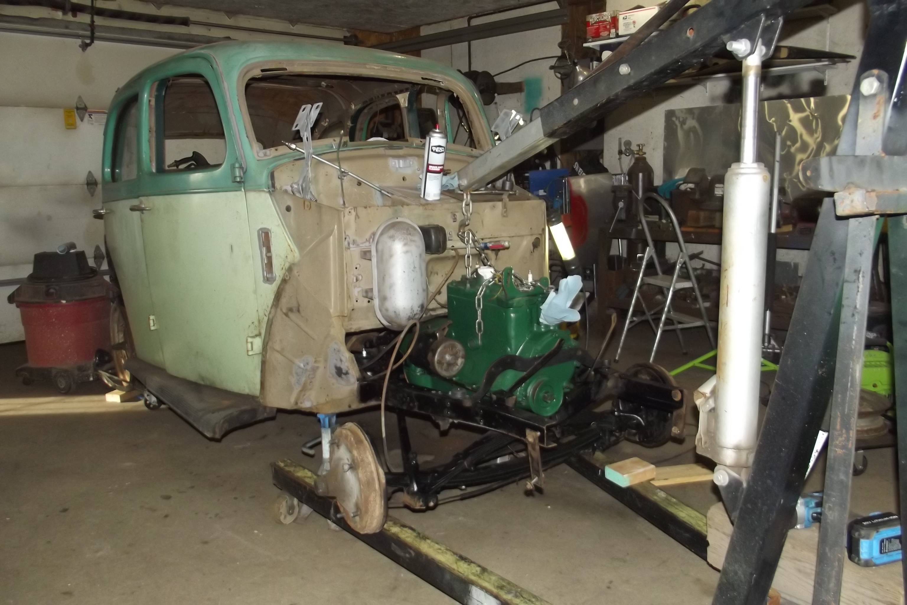

Called the local auto electric and he told me that a starter is rather dumb and they do not care if it is 6 or 12 only thing that will happen is the spring that forces the Bendix back will break due to the increased torque and when it does I bring it in and they have some type of gizmo to replace the spring
Depending on the design you can also break the starter drive gear with the extra torque.
