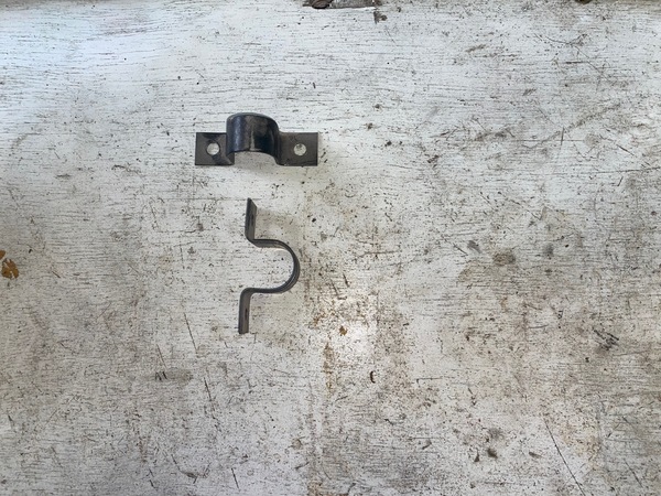

I have a problem in finding out how the bench seat is fastened to the floor on this prefect ant help? Jim
I suspect it is like the '48. There should be 4 "U" shaped straps that bolt down through those 8 holes in the wood floor. There should be caged nuts under the floor, 1/4-20 if I remember right. I can post a photo of a strap but I don't have a weekend care giver for my wife so can't get it before Monday. On another thought, I am trying to install the rubber retainer strip for the fabric top insert. This is proving to be almost impossible. How in the world did you do it?

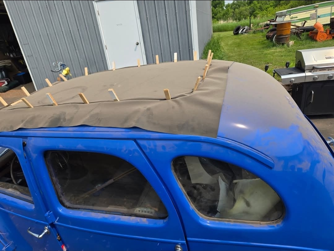

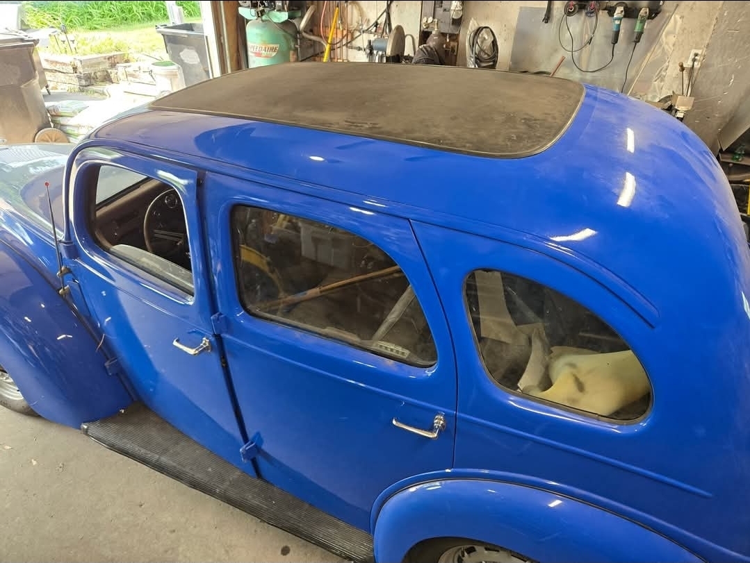

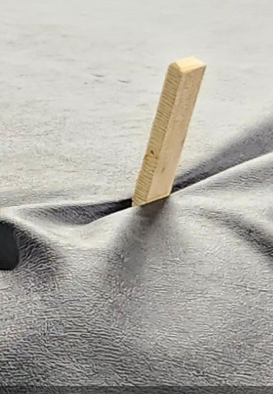

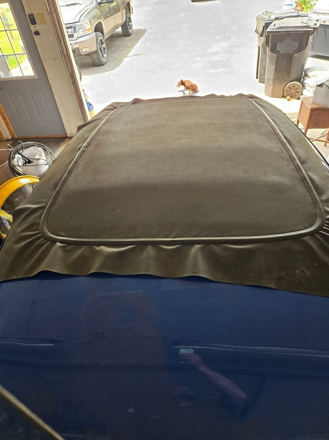

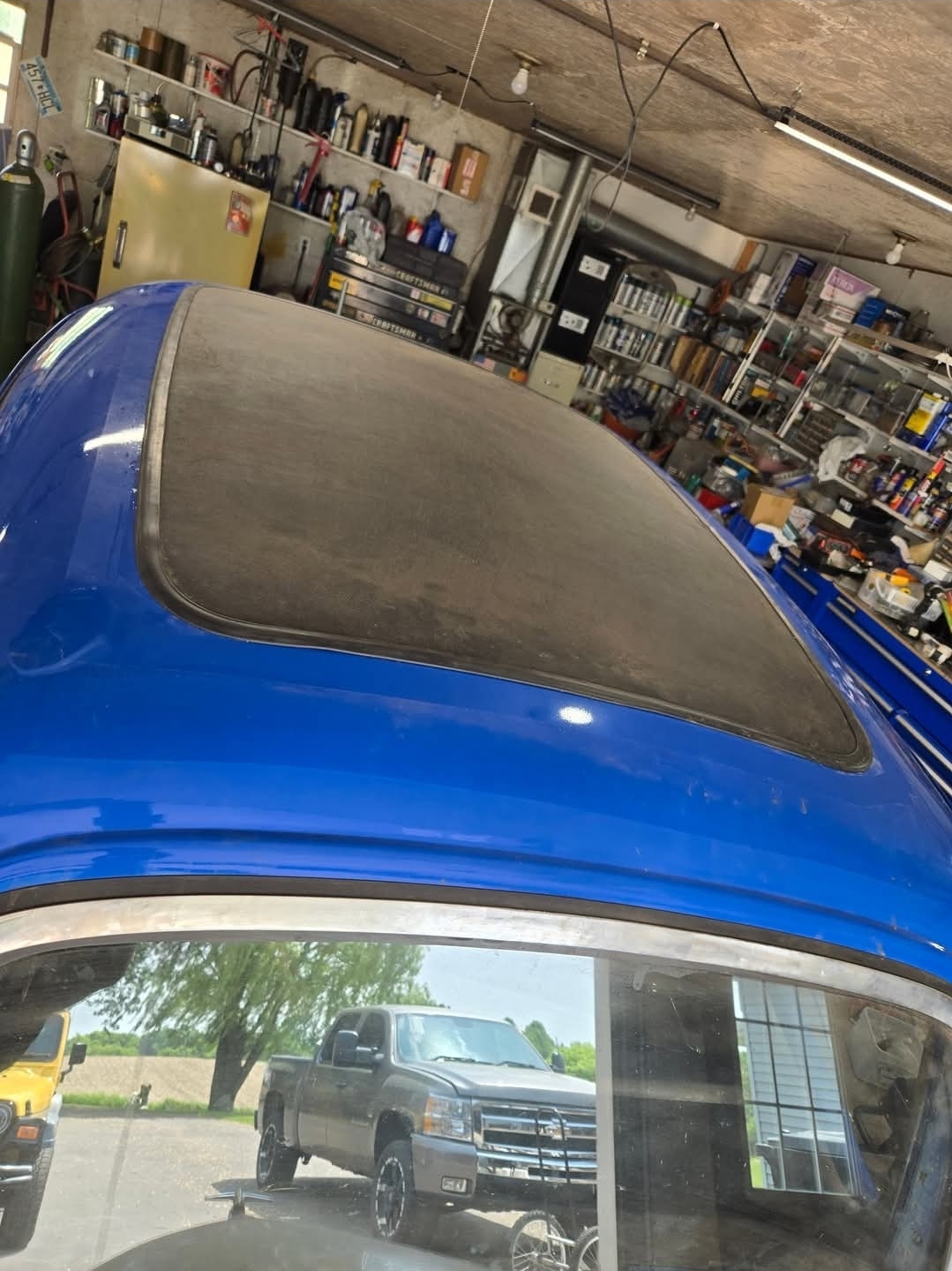

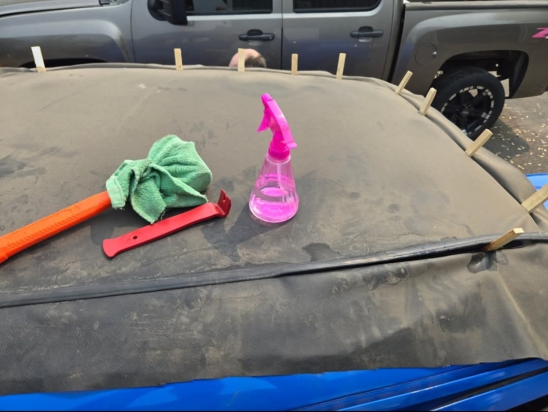

Here is what my son posted on a different site and I hope this helps everyone with a soft top.
How to install soft top.
2 people is preferable but this is how you struggle by yourself like me lol. Make sure it's hot or very warm outside or in garage as the vinyl needs to stretch a bit. If you don't have the old seal like me, use wedges and make sure you round the wedge so you don't tear the vinyl. (As you are putting in your seal that you keep checking your wedges that they are tight) Start in the back middle, wet the vinyl and under the seal constantly as it dries up. You start off by pulling on the vinyl while you push the seal to the inside to catch the lip. You will be leaning on it (to keep vinyl tight after pulling on it) with your forearm and left hand which is also holding the trim tool in a convoluted position and gently tapping the rubber seal into the channel (trying not to tear the vinyl top). I would get about 3 to 6 inches in then hammering the seal down (dont forget to keep it moist, trial and error will tell you how much to use, check wedges). Corners are the worst! Once you get as far as you can on the corner go past the corner & get it in on the other side then work backwards on that corner as it's easier to get the rest of the corner in. Water, Trim Tool & Covered Dead Blow Hammer.

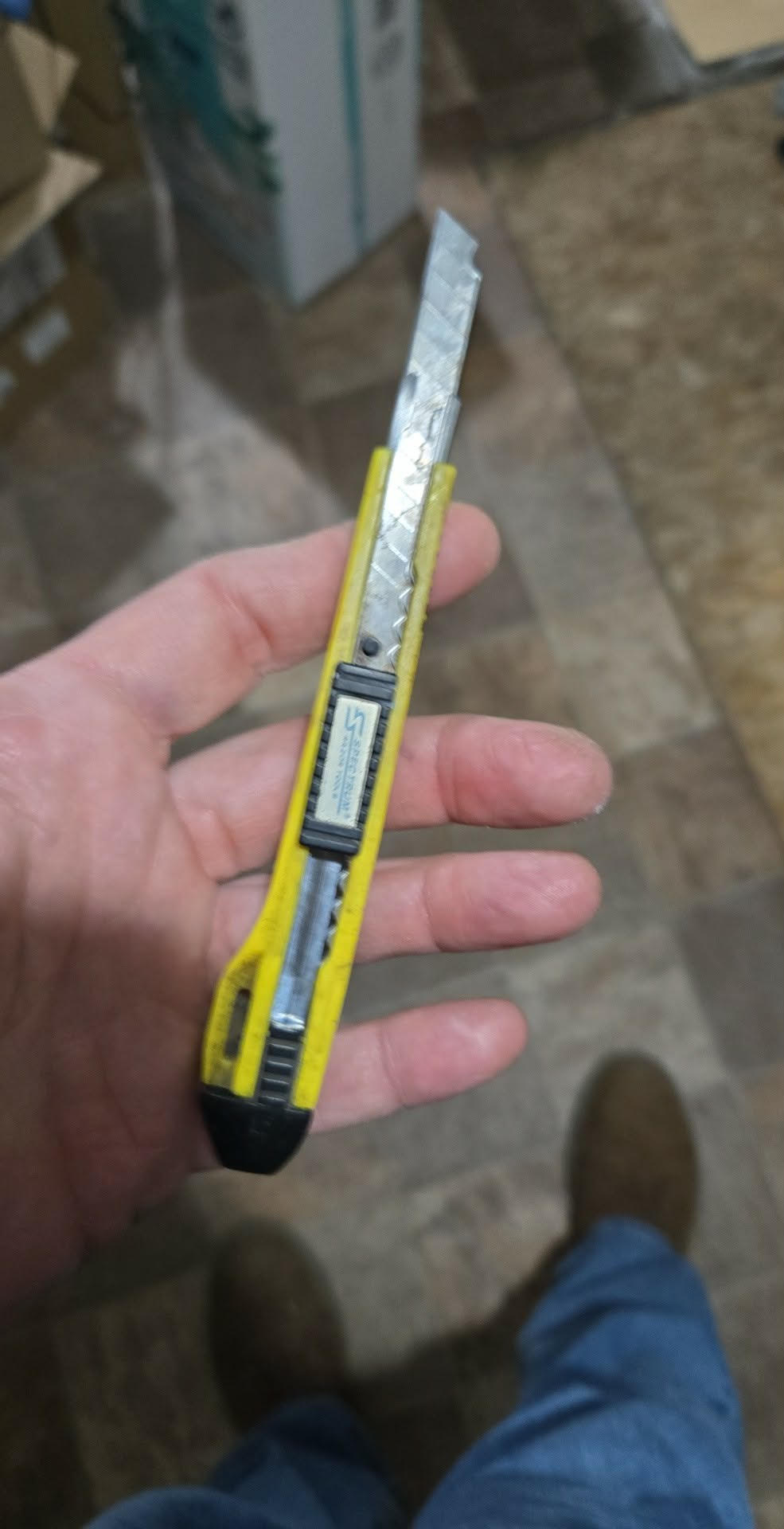

My son revised his how to install soft top:
2 people is preferable but this is how you struggle by yourself like me lol. Make sure it's hot or very warm outside or in garage as the vinyl needs to stretch a bit. Tools needed are Water in a small spray bottle, Trim Tool & Covered Dead Blow Hammer. If you don't have the old seal like me, use wedges and make sure you round the wedge so you don't tear the vinyl. (As you are putting in your seal that you keep checking your wedges that they are tight) Start in the back middle, wet the vinyl and under the seal constantly as it dries up. You start off by pulling on the vinyl while you push the seal to the inside to catch the lip. You will be leaning on it (to keep vinyl tight after pulling on it) with your forearm and left hand which is also holding the trim tool in a convoluted position and gently tapping the trim tool on the side of seal to get rubber seal into the channel (trying not to tear the vinyl top). I would get about 3 to 6 inches in then hammering the seal down (dont forget to keep it moist, trial and error will tell you how much to use, check wedges). Corners are the worst! Once you get as far as you can on the corner go past the corner & get it in on the other side then work backwards on that corner as it's easier to get the rest of the corner in. As for trimming the excess vinyl I lifted the seal & vinyl and stuck my long skinny razor knife in with a fresh blade and cut it right before it goes into the channel that way the seal sits nice and flush against the roof.
*I hope this helps others, posting this 8 months after I did mine so I'm hoping I remembered everything I did*

Here is a photo of the seat retainer straps.
Thank you, and that is the parts I have only problem was I had to insert a washer under the brackets, otherwise, it clamped too tight and would not move.
