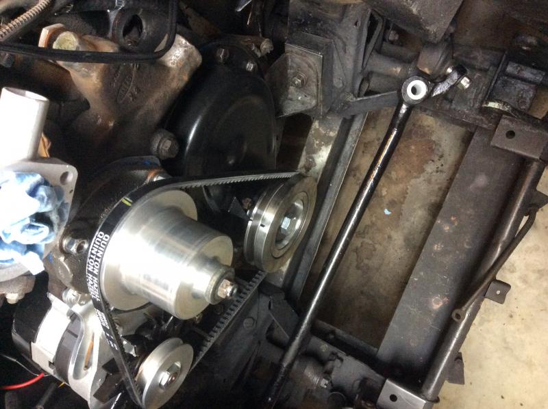

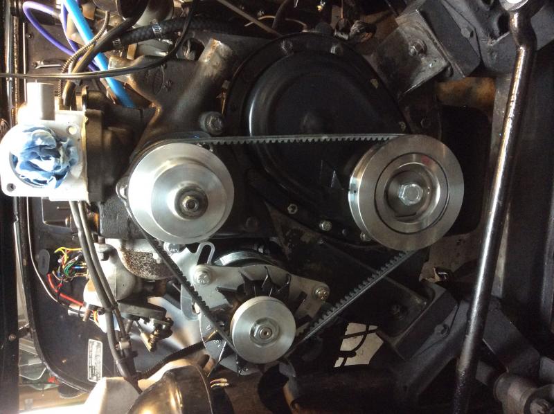

The new alternator & pulley, new water pump & pulley , new dampner crank pulley all lined up and the belt was easy to install.

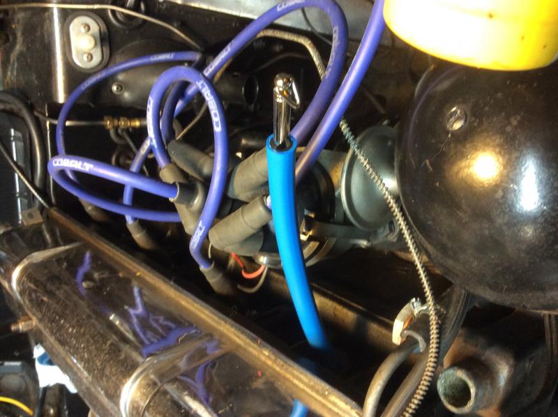

tightened everything down. Pulled the #1 plug and inserted a TDC whistle indicator( I took a pic of this thing, [see below] It worked great and doesn't require inserting a probe in the cylinder.) marked my TDC. And am feeling pretty good right now.
