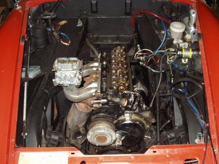

After pulling my motor for the fourth time (don't ask its been a long year) I finally got smart and replaced those long nuts with the shorter ones. It worked much better after that. Also, check to be sure your Pierce (sp) manifold is clearing your exhaust manifold and not laying on top of it. I got everything installed and thought it was tight but there was a small gap around the bottom of the intake manifold that you couldn't see but it was caused because it wouldn't flush up. I ended up grinding the two spots on the exhaust manifold off where it was hitting. ( I think this was where the previous manifold attached maybe?)
I don't have a header exhaust and this is why there was a conflict in my midget.
