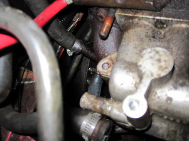

Got my new Weber DGV conversion, and already ran into a snag. The rear bolt connecting the intake to the exhaust header sheared the head off. Now with the Cannon manifold it doesn't look like I'll need that bolt, but I can't get the manifold to let go. It appears that I might be able to unbolt the rear lifting bracket and slide the manifold up, but it sure seems pretty stuck even with some rubber mallet persuasion.
Next question, the lower nuts holding the manifold(s) were a pain and a half to get to, but fortunately they let go nicely and I got them with the open ended combination wrench. That's the good news. Is there a magic trick to getting them back in? I could just about reach them with the tips of my fingers to unscrew them. Or can you put the manifold on while the nuts and brackets are in there?

You're going to have even more difficulty putting those lower 2 nuts back on with the new intake manifold. I used a open/closed wrench with a 3/8" drive ratchet extension as a T-handle in the closed end and was able to turn the nuts about 1/4 flat at a time -- very tedious. If my memory serves me correctly, you can have the nuts and brackets on when you install, but you'll be futzing around under there to get things lined up. You may have to shave away part of your exhaust manifold (where "rear bolt connecting the intake to the exhaust header sheared the head off") in order for your new intake to seat properly.

FYI; on a 1500, the intake is pinned to the head with dowel/roll pins. With the nuts removed from the studs, you need to pull is straight back about half an inch to get it off.
See that drilling in the intake manifold between runners 3 and 4 (upper right side of your photo)?. There's a pin in there. And another on the other side between 1 and 2.
Those inner nuts are no fun- but you should find it a little easier with your new manifold.

When he says back, he means towards the fender, not the rear of the car.
