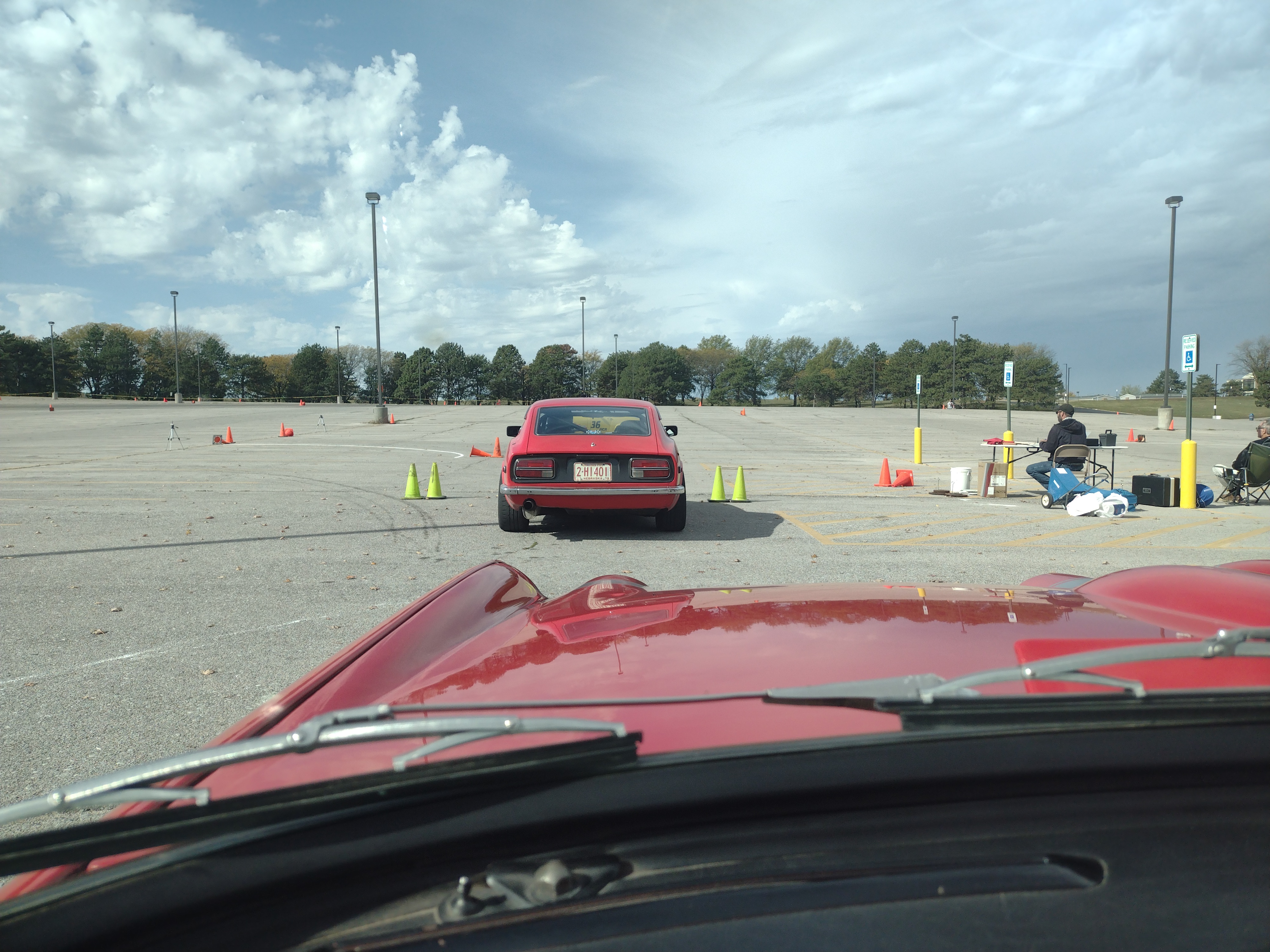

Tybalt, thanks for the info. I don't run in SCCA, it is our local British car club and very much a "formula libre" situation. My goal with the TR250 was always to make it perform better without making it awful to drive on the street. I have Addco front and rear sway bars, Koni shocks, Nissan R200 diff, lowered about an inch front and rear, stock springs, 7" x 15" Konig rewind wheels.
The new tires I got are 205/50s. They will be autocross use only as they are marginal street tires and my ground clearance with the new tires will be pretty low.
Most everybody competitive is running 200TW tires the last few years, lot of Miatas in the mix too.
