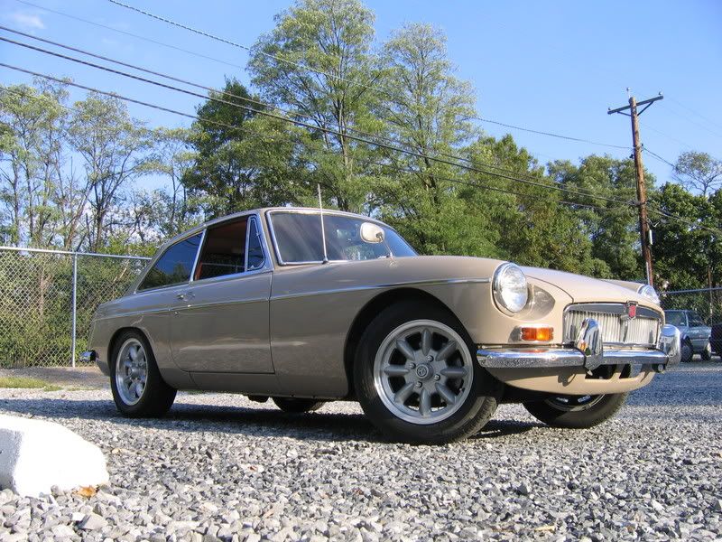

MGB 15" Minilites for a MGB
Re: 15" Minilites for a MGB
Good looking GT. Welcome.

I run 15" Superlights on my GT with 195/60/15 Sumitomo HTR200 tires. I love them, but I had to replace the rear spring bushings with poly to stop them from rubbing.

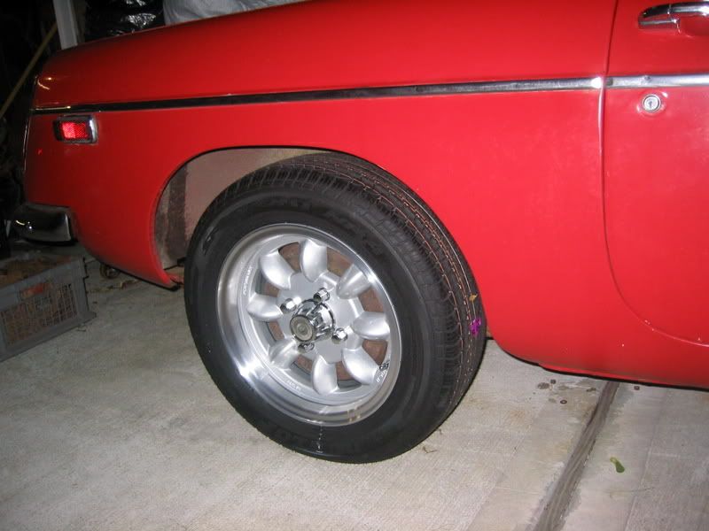

I got these 15 inchers from Hap and am running Dunlop HR4's 195/60, poly bushings and GT springs. Front end it shot but she handles very nicely.
