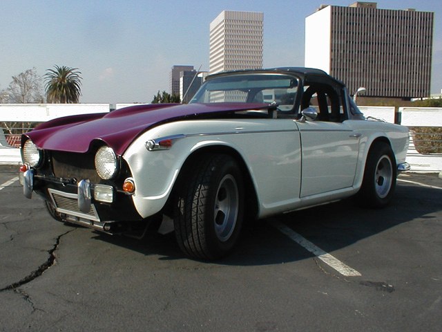

Not the best shot (and he has since fixed up the body work better), but here's what they look like on a TR4

Okay, that should be helpful. I think they actually work well with the overall approach of that 4A -- so I would say it depends on what look & function you are wanting.
Thanks guys - I wasn't sure if the old tires on the rims was making them look, um, bulbous or if it was just the nature/size of the rims.
I'm not really looking for a tire sticking beyond the fender look.
I imaging they'd be pretty similar on a TR6, no?

Tom, your wheels are less wide than the ones in Randall's pic so I don't think wheel protrusion would be as big of an issue. Also adding to the "funny" look of the 4 is on top of smaller wheels they have low profile tires.

<div class="ubbcode-block"><div class="ubbcode-header">Quote:]Tom, your wheels are less wide than the ones in Randall's pic so I don't think wheel protrusion would be as big of an issue.[/QUOTE]IIRC, the owner told me those were 7" wide rims. The extra 1.5" is all to the outside of the car, as otherwise they would hit the suspension (or the rear frame on a TR3). It's possible he has some spacers behind them (for suspension clearance), but I don't think so.
<div class="ubbcode-block"><div class="ubbcode-header">Quote:] Also adding to the "funny" look of the 4 is on top of smaller wheels they have low profile tires. [/QUOTE]
Which were required in order to clear the fenders without making large modifications to them. That was the reason the owner went to 14" rims, so he could use wide tires without having to chop up the fenders.

I don't think they would clear on the earlier cars with 11" discs, but depending on the wheel, might fit on later cars with the smaller front brakes. If I see the owner, I'll ask him.
