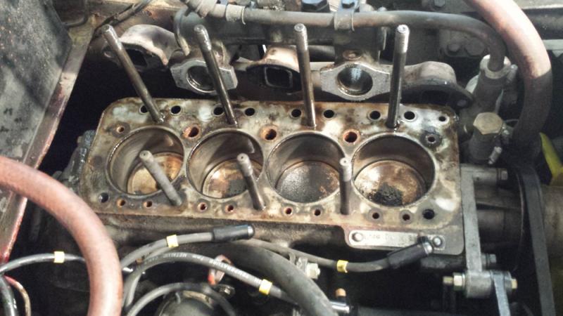

I have a puzzling problem. My '65 Sprite (which has a 1275 instead of a 1098) produces a large cloud of white smoke right when the thermostat opens as the car is warming up. The smoke only lasts a few minutes, and the car runs fine before and after the smoke episode. There is no oil in the coolant, and no coolant in the oil, so I assume that a little coolant is somehow slipping past the head gasket and into one of the cylinders for a short period of time right when the thermostat opens.
My hypothesis for this is that the influx of cool water into the head is causing some local and temporary shrinkage somewhere that is allowing the coolant to get past. Yesterday, I popped the head off to see if I could see a problem, but everything looks pretty good to me (pictures attached). Any ideas on what could be happening?
My current plan is to run the head out to my local machine shop to have them check how flat it is, then reinstall everything with a new head gasket and see what happens.
I'd follow your present plan (as described). Also, make sure that the brass blanking plugs are all flush (on the head).
Reassemble with the black Payen gasket and ditch the copper sandwich. Crack check might be a good idea.
Kurt.
The head is now at the machine shop. They didn't see anything obvious, but they're going to clean it up, magnaflux it, and resurface it. I'll pop it back on with a Payen gasket and see what happens.
I've heard of other people with this exact problem. I've never heard of a solution. Ask Peter C. if he remembers who had this issue ... I seem to remember that he was part of the conversation.

I'm betting head gasket or recession of the brass plug between 2 and 3. If not start looking for crack's in a cylinder!!
Kurt.
I'm now leaning to head gasket... but I don't get the fact that it happens when the thermostat OPENS.
My hypothesis is that when the thermostat opens, the cool water from the radiator hits the engine and causes the metal somewhere to shrink transiently and open a tiny crack, either in the head itself or around the head gasket. As temperatures even out, the crack closes.
I know it sounds a little far-fetched, but I can't think of any other reason that the appearance of the smoke would be so tightly tied to the opening of the thermostat.
Here's another observation. If I allow the car to warm up slowly, by driving gently or letting it sit at idle, there's no smoke when the thermostat opens. Iif I start the car cold and drive it normally while the temperature comes up, when the temperature gauge hits 160 -- Smoke!
