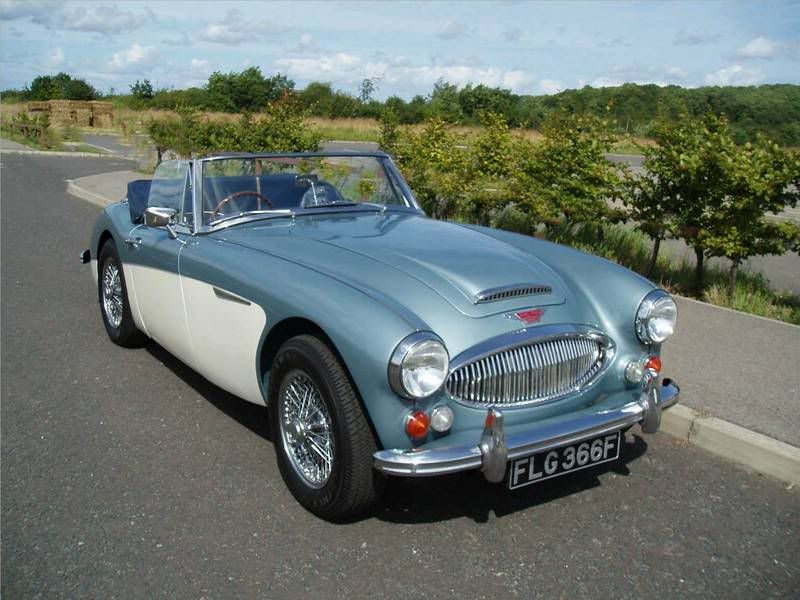

I have just had a 123 dizzy delivered last week, it went straight back to the supplier the following day! Why? After changing the polarity and luckily I had the sense to put a mark on the old Lucas dizzy and clamp plus body in case of any problems with the 123!! I could then change it back.
After taking out old dizzy fitted 123 all as instructions given, started engine, it ran for 30 seconds then gave up, after that the engine never fired up again with the 123 fitted, I even had a 123 Specialist guiding over the phone. Now normally my engine aways fires up 2 try even with a half flat battery and a worn out dizzy. The 123 was then taken out and my old dizzy of 40 year's old refitted to the marks I had made, and yes you guessed it, fired immediately. My supplier was contacted and I was asked to send it back, for a refund. I was informed by them that they had been having a lot of trouble with the 123 for BJ7 & BJ8! but I suspect it is a lot worse and other models are involved from what I have since found out?
I have been in touch with a few of the Healey racing people here in the UK and they just laughed when I asked them what they thought about the 123! Too unreliable I was told, also if they decide not to work they cannot be fixed easy, and definitely not at the road-side. You can aways get and old Lucas dizzy to work if you carry a few spare parts.
However I have now rebuilt my old Lucas dizzy and it is well packed and safe in the trunk should I need it.
In it's place after much liaison with the racing fraternity, I fitted a Mallery, that is what most if not all racers use in the UK, very solid piece of kit, it is mechanical and not a mini computer like the 123. I have re-tuned my engine to it, so far I am very impressed, I think I might change the condenser to a Lucas and keep the Mallery condenser as a spare.
https://i21.photobucket.com/albums/b287/vvs393/P72800088.jpg
https://i21.photobucket.com/albums/b287/vvs393/P2210005.jpg
