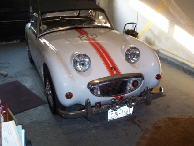

Picture 004_640x480.jpgi I GOT MY SPRITE 2001 WITH A 1098CC ENGINE.....I GOT A 1275 WITH RIBBED TRANNY...I WAITED FOR THE 1098 TO KICK..IM' STILL WAIT IT WILL NOT QUIT........KEEP THE 1098 FOR LUCK......WILLIE

Here is the story so far..
It took about a month to get a spot for them to take the car into the shop, and another month before they started work. When they took it apart they could see that it needed a new clutch disk, so we waited for that to come. In the mean while I had put them in touch with Gerard if they had any questions. There, (Gerard's websight) they saw his rear seal kit and thought that would be a good idea, so I ordered one. Well, Gerard was out at the time but was having some made up, as he had gotten enough orders to have them made at a reasonable price. By the time they came another month or so had gone by. At that point I mentioned that my gas gauge has NEVER worked so if they wanted to drop the tank to hook up the ground wire that I had knocked off and had "escaped" back to where I couldn't reach it, to please , go ahead and get my gas gauge working. .. Turns out whoever put that tank in the car had put in wrong one, so the bung was wrong to be able to put the right sending unit in. (we're most of us aware of the non-interchangeability of the sending units) so they ordered these parts from Moss. .. They want to (as do I) take the car to a dyno tuner to get the WEBER dialed in. We know what a PITA they can be if you don't have all the right jets and the time to get them right, but they couldn't do that because the gas tank was out. Now we have to wait for the rains to stop so they can get the car (I didn't take the top with me to their shop) to the tuner's. . An since the rains have come, I'm in no real hurry, as I can't drive the car until Spring, anyway. ... .. Next up will be getting the cancer cut out. .. next winter.

Let me put in a good word for the 12G 295 head. I still have the original 948 in my bugeye, but with some mods.
HS2s, 88G 229 cam, LCB exhaust and a 12G 295 head. The 295 head has a greater capacity than the 948 cc head so you'll need flat top pistons or a skimming of the head to get a decent CR. But it really is a lovely motor that loves to rev (which it needs to with my 4.55 diff). And Hap, It ain't no golf cart!
