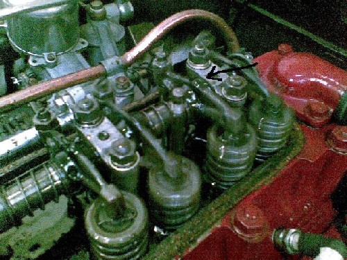

Maybe to clarify - when removing the rocker -> the banjo bolt comes out last, when installing the rocker -> the banjo bolt goes on the rocker first before installation.
