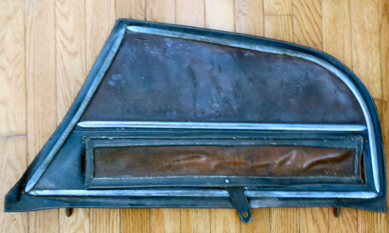

I just picked up a pair of sidescreens that are I beleive original, unmolested condition. Which means that the clear vinyl has browned out and will need to be replaced. I commenced cleaning them up a bit this weekend and have a couple of questions.
1. What finish would be the outside trim metal. It looks like this might be chrome plated, but not a really high gloss chrome?
2. What color would the inside frames be painted. Looks like silver paint to me?
3. Would there be a signalling flap on both sides of the car?
Thanks for the input
Simon

1. The outside trim metal should be bright chrome. Concours Guide info and what I have on mine
2. The inside frames are gloss black on mine which I believe is correct. The guide is mute on this.
3. Yep, both sides.
I agree the outside trim is chromed but the inside frame is a medium gray color like the hood frame on the 100-4.
mk31755 (Catchy name!)-
Do you have any documentation to confirm the gray? My frames (reproduction ones) came painted black but I have no information about what's correct. If you can offer some evidence then it'll be worthwhile disassembling them and re-painting them.
Gray does make sense as it would match the hood frame, as you say.
That was quite a find, with the original pouch and all!

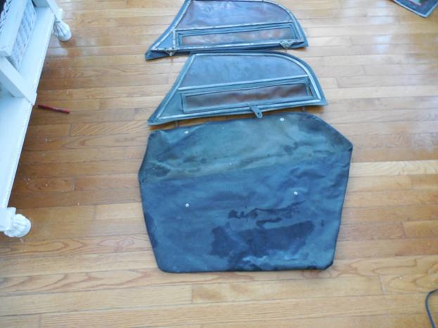

I just found a set of Type 3 A/H100/4 side curtains. Going to post them on Ebayfor sale. Anyone wants a set, contact me ASAP before I list them.
Marv
These are Type 3 I think. I let my wife post these on ebay. We'll see what happens.
Marv

G'day Marvin,
They are what I call "Type 3". Exactly like mine except those have the window in the flap.
Alwyn
