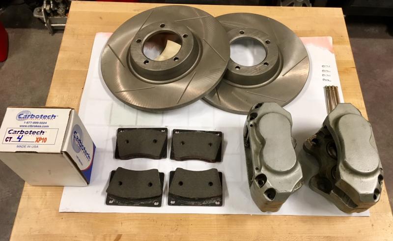

Looks like a great project with many adventures ahead. PM me when you get to the engine and suspension, my spares are pilling up, even my wife noticed :chargrined:. BJ8 400lbs front coil springs and 4-pot front disc brakes are a nice addition (I have extra of both).

The car comes with a disc brake bits, but not the calipers and rotors. Do I need different wheels than factory to run those?

Are those calipers Volvo or Jag Girlings?
You'll need 72 or 60 spoke replacements as those 48s are unsafe.

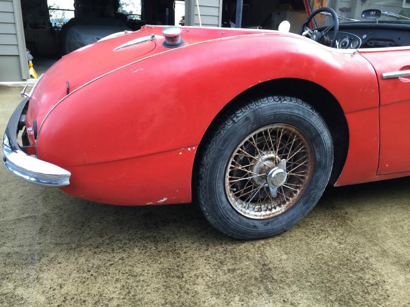

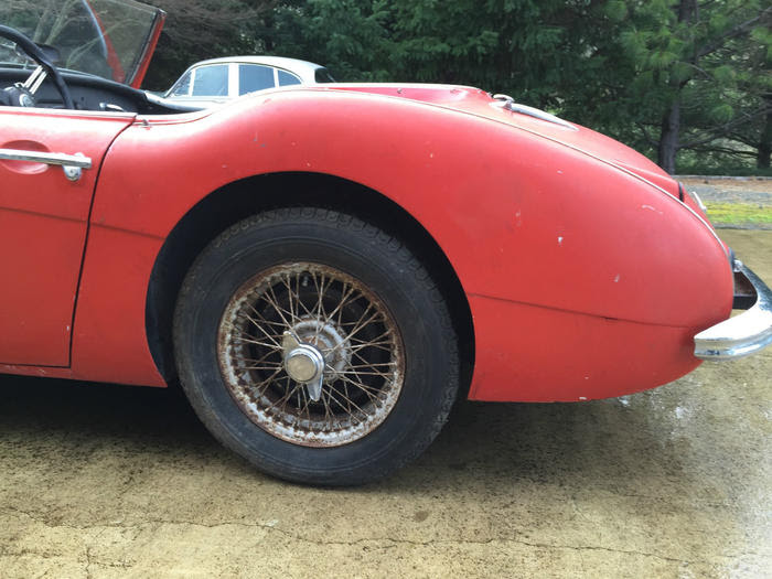

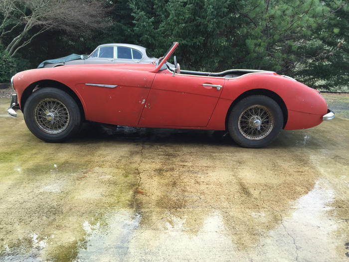

These are the best for gap pictures I have.
View attachment 51776View attachment 51777 View attachment 51778 View attachment 51779
YW. Those gaps look very good to me; the right side is perhaps better than the left. The last photo shows the correct bottom curve and the line of the rear dogleg. It's possible this car has never had serious body or chassis damage, or if it has it was repaired skillfully. This makes this car an excellent restoration prospect. Drivetrain work pales in comparison to the work and expense of repairing the bodies of Healeys, but the body is what we love (well, that AND the drivetrain).
