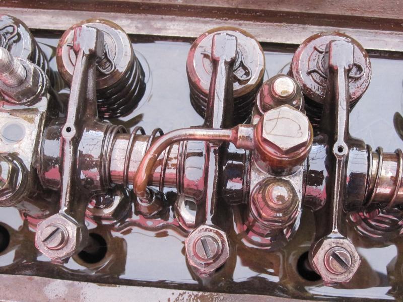

The valve cover came off easily, with no valve cover gasket in place. Everything looks fairly good under the valve cover, although a couple of the springs and spring caps had a little surface rust. Most did not look rusty at all. The pushrods, what I could see of them, and all the other parts there appeared free of rust. I poured about two liters of oil on everything and let it slowly seep down along the push rods, towards the cam shaft, etc.

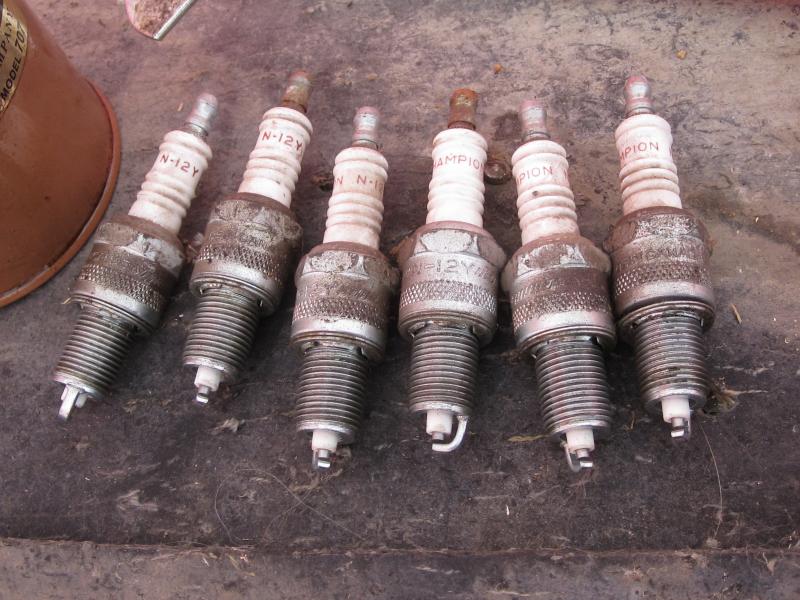

The spark plugs were only finger tight and look new, except for dirt on their exterior. There was no rust on the ends of the plugs or on the threads, which gave me hope that the inside of the cylinders might not be rusty. I then squirted lots of oil into each cylinder before trying to turn the engine.

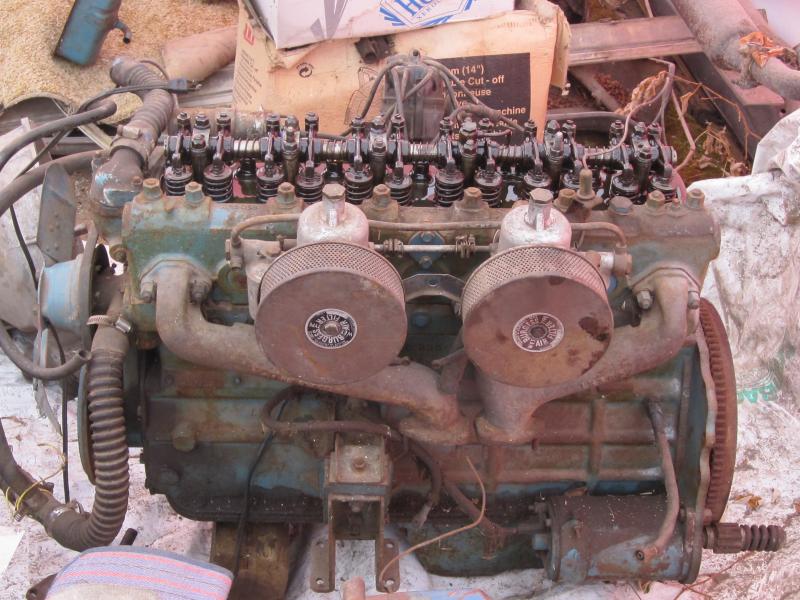

Here are a few pictures, complete with decades of accumulated dirt:

Based on the appearance of the engine, I would say that it has never been apart and never been to a machine shop. It's too dirty, and the starter is still attached as well as the coolant hoses. Looks more like someone just pulled it out of a car. I would doubt that someone rebuilt the engine and just didn't run it.
That said, I doubt that you could do too much damage by trying to start it.

"Rebuilt" might have just been rings, rods and mains (which I would do at a min plus valve springs and a lap.)
Fire that puppy up! That Longbridge motor will probably run just fine. They are not the strongest running motors but they do run smooth.

Hook up a battery , spin it over and do a compression check/test . If that's all good give it some gas and fire it up .

The adapter plate that bolts to the engine between the flywheel and engine could be flipped, putting the starter hole on the wrong side. The trans will not bolt up with it that way though.

Thanks for the info. That might be another bit of evidence that someone took this engine apart and put it back together since it last ran. On the other hand, I'm now wondering what else they assembled backwards.
Dandare
The Austin saloons (sedans) of this period that used the 2639cc C-series engine have this orientation of backplate and starter motor and, of course, the bellhousing to suit. Could it be that this is not a Healey block?

Take it apart. there are too many unknowns. steam it down, take it apart, mike the clearances everything might be good. you may not have to buy very much new to put it back together but then you know what you have and it will be clean, gasketed, and painted. you'll feel much more comfortable each time you drive it knowing the engine is alright. Without that cardinal knowledge you'll always wonder if it is going to give you trouble at some point. And then you may not take it the distance or enjoy it as much. Dave.

I now have looked for casting numbers on the block and head. The block casting number is AEC 335 and the head casting number is AEC 666. That block casting number is the correct number for the early 100-6 cars such as this one, and the head casting number is correct for cars with engine numbers after #30000. According to the heritage certificate, the engine number for this car is after 30000.
Based on the casting numbers, it seems that both the block and head are "correct" for this car. So I probably will keep going with this one for now.

Pull the flywheel and see if the plate can be flipped to put the starter on the correct side. If not it will do you no good as the trans. wont bolt up.

If this is really the correct engine for this car, and the backplate is really on backwards, I wouldn't be so tempted to try and start it. If the person who "rebuilt" it could get the backplate on backwards, who knows what else they did wrong.
