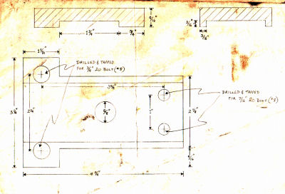

Boy, I do know what you mean Trevor! Those U-bolt/anchor plates were such a PITA that I actually went to a machine shop and had these made! (years ago as you can see from the color of the paper I drew it up on!) Definitly eased the job, and also more robust! As you can see, I replaced the U-bolts with grade 8 steel bolts and the plate is made of steel. They were a bit pricey to have made but the agravation factor that was eliminated was well worth it and the hardware is more substantial than the originals!

You posted that before I installed the springs the first time. When I looked at your drawing, I thought it looked like a good solution, but probably not necessary. However, I think I'm going to print it out and take with me the next time I go to my dad's shop.

:thumbsup: I did not recall posting that before :crazy:...must be getting old!! :rolleyes:
Yes, I had mine out about six times to get it right, I replaced all of the hardware and got pretty proficient with it.
