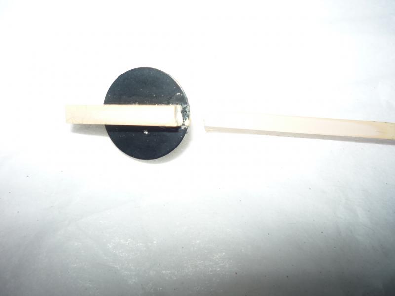

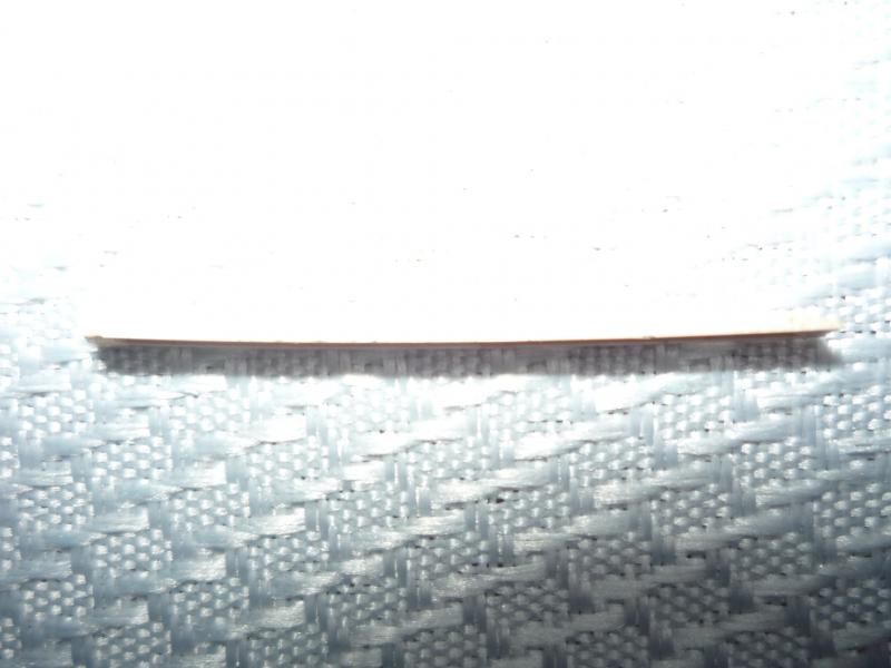

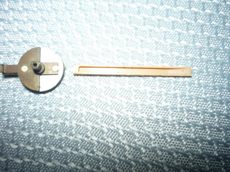

Yes they are. Use care in removing it though. The plastic needle is mounted on a metal base and is very brittle from aging. It is prone to breaking at the end of the plate. Here is a shot of my broken needle; I suppose it could be glued back and carefully painted. The needle seems to have a slight curve to it, maybe creating a weak spot. P1110287.jpgP1110290.jpgP1110289.jpg
