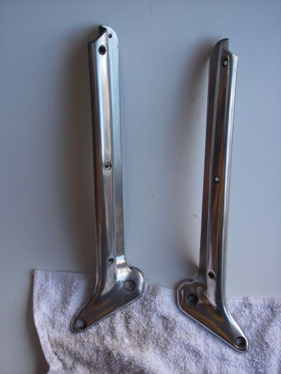

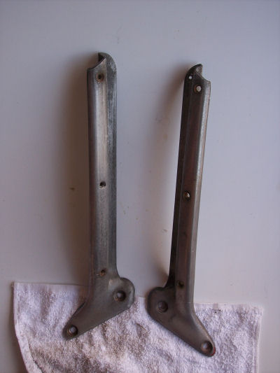

I did mine by first sanding them down with 1600 grit sandpaper, then I used Barkeeper's Friend to clean them up and followed that with polishing compound and a buffing wheel! They came out like this....

And they did come out lovely Mike. Now I have an extra pair I could send you and...................

Yes, they can readily be polished. I did mine with a Porter Cable random orbital buffer, different types of pads, and several of the products in the Wolfgang Metallwerks product line. They turned out rather well.

Mio, can I send you mine. Wow, what a nice job.
jvandyke
Are you serious? That's a polish job, not chromed? That's amazing. Looks like I have a winter project now too!

Actually, yours did come out exceptionally well in comparison to how they were when you started. As you know, all it takes is persistence, patience, and proper tools and a greater shine can be achieved.
