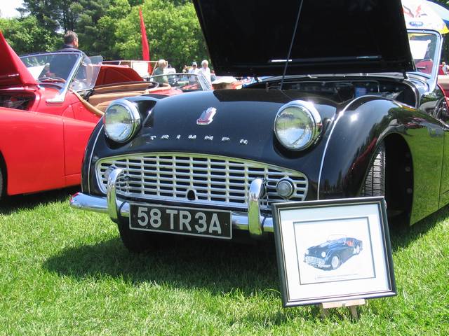

Twenty years ago, I had the front bumper straightened and re-chromed. They did the inside as well. Now after 103,000 miles and 20 summers, the chrome still looks like new.
So, some day, when you decide to have yours re-chromed, have them do the inside as well. Till then, you have lots of suggestions above.
