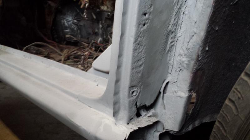

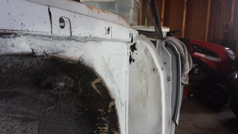

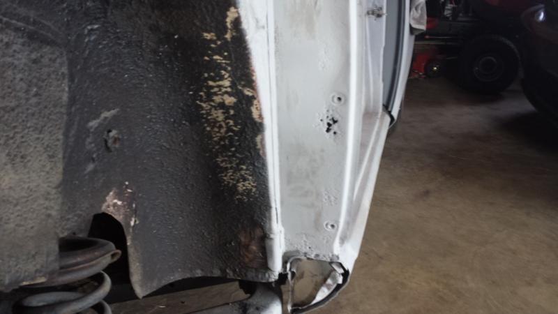

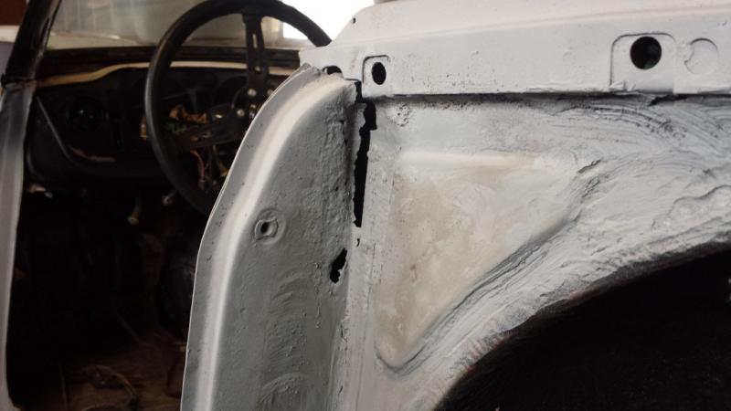

Just a couple of new pics of some of the rust I have uncovered. This is the worst I have found so far. The other side looks similar but is not quit as bad.
I plan to order the replacement panels for this repair.

I have been working on cleaning off the undercoating, which has been no easy task, and so far the rocker panels and floor pans are actually in pretty good shape.
One thing that concerns me is that the PO put on a new rear panel without replacing the inner panel. The inner panel has some perforations but the outer panel is brand new. I don't know if I can remove the inner without removing the outer.

Here are a couple new pics from todays work. I removed the sill end cap and looked into the rocker. It looks very good.
Once I remove the back of the B pillar the other rust will be exposed and I should be able to take care of it.

That sill looks in good shape.
Take a paint bush and tape it to a broom handle.
Soak the brush in POR15 and saturate the cavity so you will never have to worry about it again.

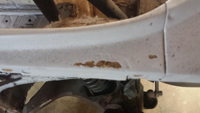

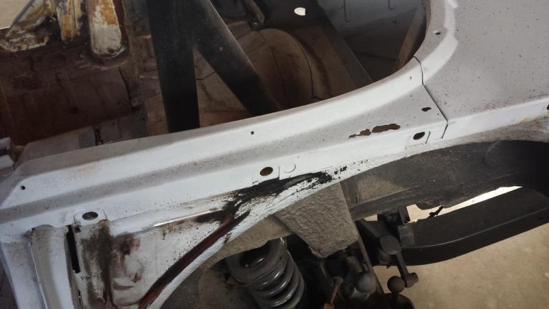

Some pics of the latest round of cleaning and grinding.
As it turns out I have the replacement panels for the deck area in my my boxes of parts. They have some surface rust on them but nothing serious.
Yes I bent the sill end cap a bit. I have new ones and was in the process of grinding the spot welds out so I can do some rustproofing and check the sills for damage.
I have a new 140 amp MIG Welder and have been practicing. Still not real pretty but getting better.
