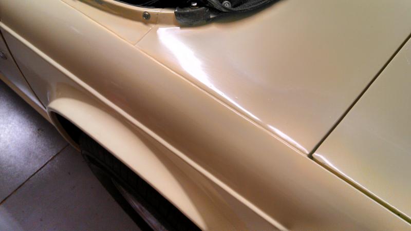

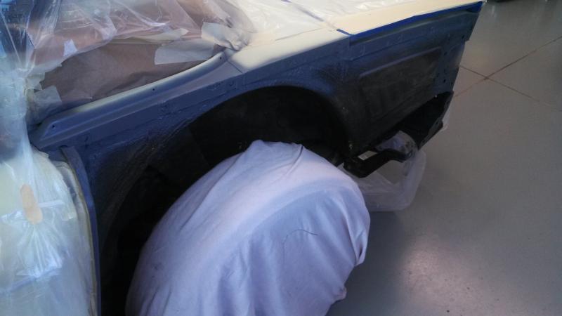

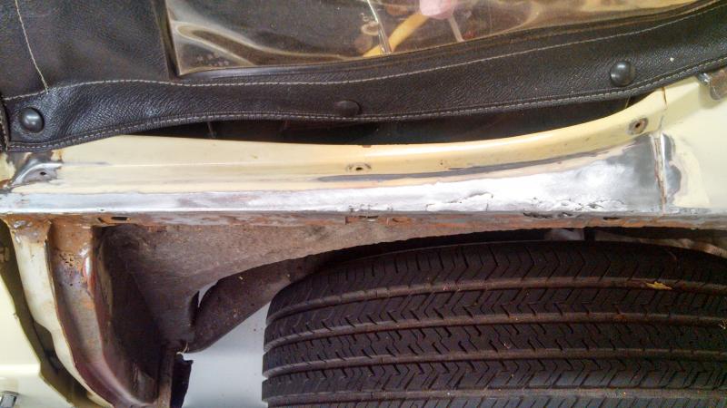

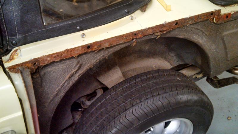

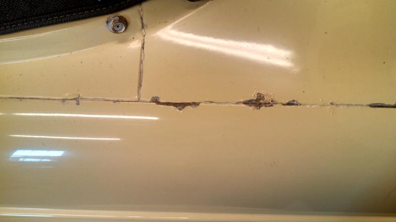

I was faced with this issue last year on my TR6. It's a decent looking car and good example of a survivor. It was showing rust in the rear fender seams and I wanted to stop it before it got worse. I ended up removing all the fenders and cleaning, repairing rust, priming, and the spot painting them. Yes, it shows, but you have look twice to see it. I have the peace of mind that it is not getting worse.IMG_20140125_161717_135.jpgIMG_20140201_165957_372.jpg16632.jpgIMG_20140301_132322_231.jpgIMG_20141110_220031_888.jpg
