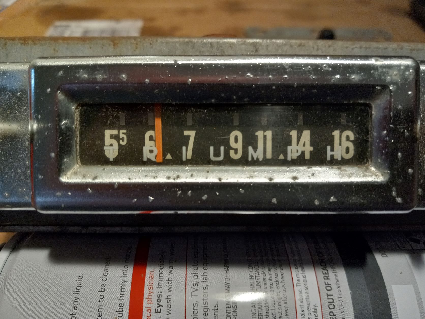

As I was going through boxes of old parts for my 1955 Triumph TR2, I came across a radio.
As the front of the radio dial has TRIUMPH printed on it, I expect that it may be the original radio for this car.
Does anyone have information about what kind of radio came with the Triumph in 1955?
Thanks for any information that others can provide.
JC

Sarastro

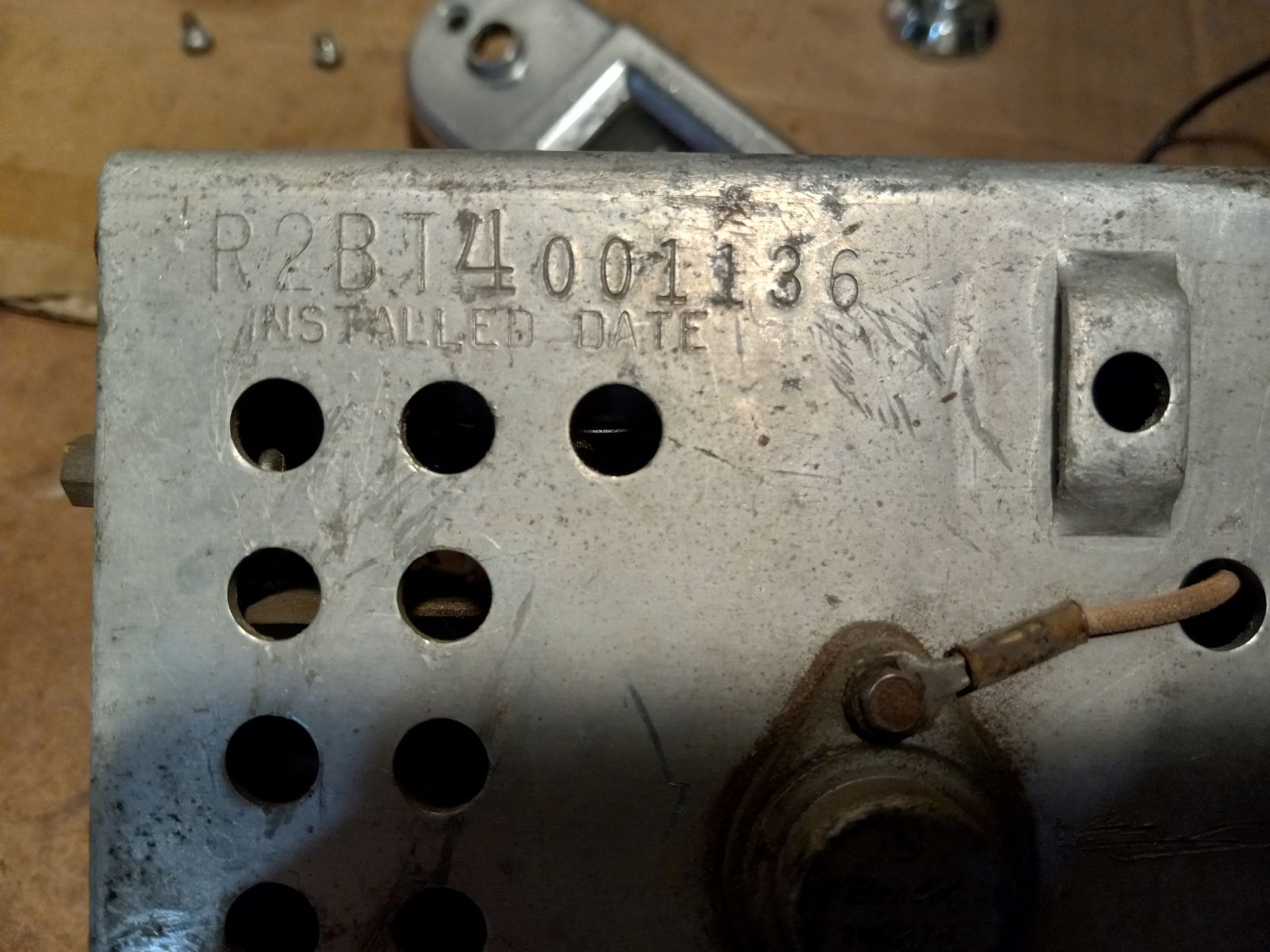

Radios were a dealer-installed option, so none really came with the car. That said, the radios they installed were invaribly Triumph branded, as yours is. The use of vacuum tubes is consistent with a 1955 car. Beyond that, it's hard for me to say. You might look around inside for a date code on a part or on the radio itself. That 'installed date" stamp is intriguing, but probably the date was on a label, which is long gone.

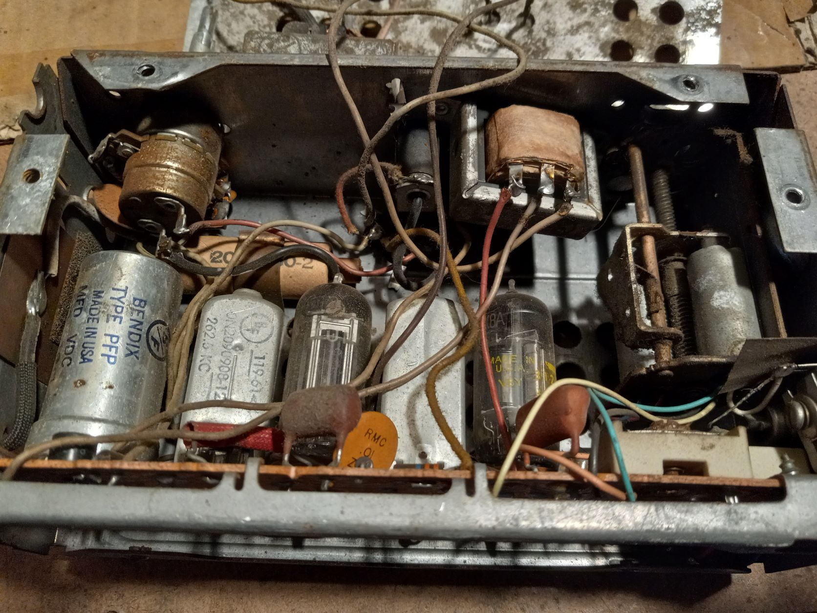

JC, It looks like the 2-tube Bendix radio that was fitted to some early (mine at least) TR4s ~62-63. Does the chrome faceplate with the dial & pointer come completely off? Jeff

There should be a small 'button' on one side, which is a plug to select + or - ground. You have to pull it out and line up a notch with the desired polarity. I'm going of distant memory though. Should be some wires for a single speaker too.

In the second image that appears to be a power transistor mounted to the chassis. Is that possible for a 1955 radio?!? I believe that radio came from a later time.
Graham H
If you look at TeriAnn's Triumph TR2-3B web page she has some good info on the early radio instalations.
Graham
NutmegCT
Yep - closer to 1962.
"R2BT4 was documented in the June 1963 issue of SAMS Auto Radio". (from TR3Driver Randall, RIP)

I located a copy of June 1963 issue of SAMS Auto Radio, so after I have a chance to read through that, I expect to know more about this radio.
I still don't know whether or not it works, but at least I found a source for replacement tube.
