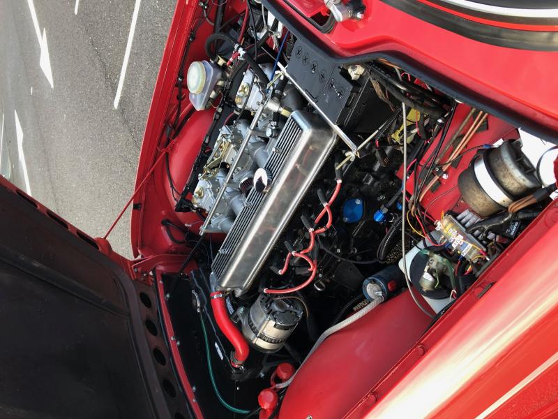

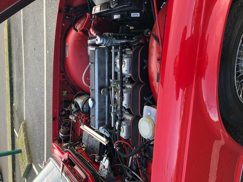

I have just finished converting my '69 TR6 to EFI. I have fitted an Emerald K6 ECU, triple Jenvey Heritage Throttle Bodies on a Racestorations DCOE manifold. The engine is a saloon block with a lightened & balanced rotating assembly, bored out to +30. The cylinder head is a Fast Road spec' from Peter Burgess and the cam is a PH2 from Newman. The car went on the Rolling Road at Emerald on Friday and produced 178.9bhp, I was very pleased with that.

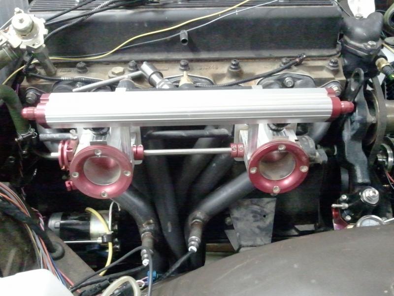

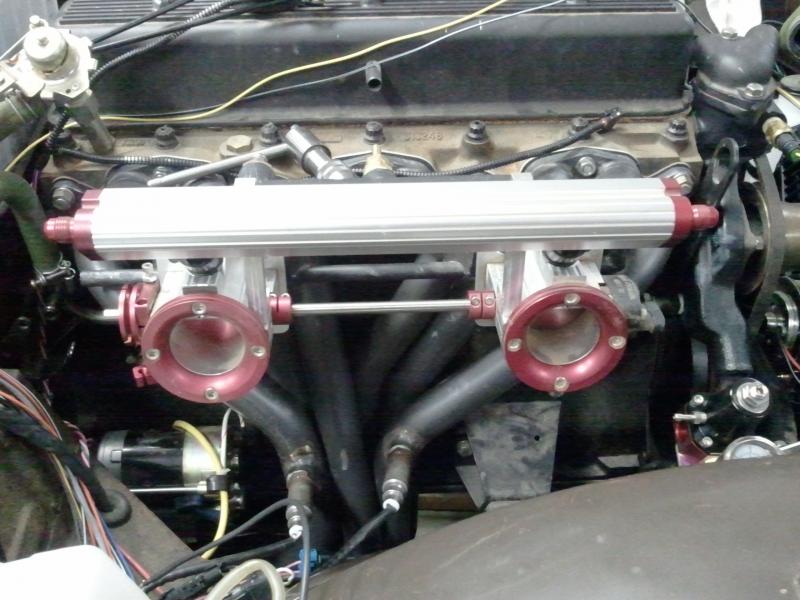

Very simple solution
You can adpt this to Patton's system

You installed the O2 sensors on the header branches from the outer cylinders, 1 & 6. I think I know the reasoning, but please explain.
And also curious to know how you dealt with crankcase ventilation.
Andy
DNK
The 2 ITB's feed 1-3 and 2-6 respectively
The 2 tubes in front were the easiest.
Crankcase ventilation?..., same way the stock did it
