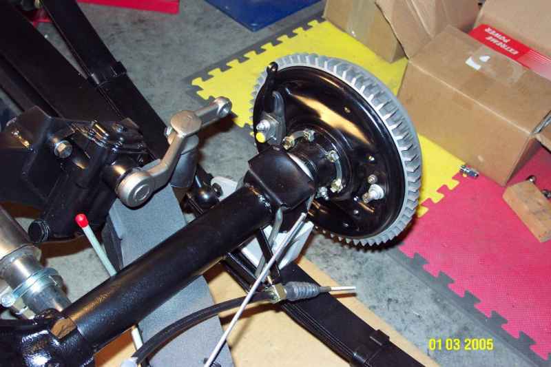

OK Jerry here goes. My 4A is up on the lift and the 3A is below it so I can't get close enough to take new picture or measure. BUT, I do have these picture from when I did my chassis.
One pic per post
PeterK
Notice that the bumper pad is directly above the sprint purch and u-bolts, which actually run through it. Eyeball size would be 2-1/2" x 3" and roughly 1-1/2" high with a 1/2" concave in the center.
PeterK
This shows the difference in the spring bloks.
On the left is Stanpart 212225 from a TR4A - measure from the rear (left in the photo) edge, 5-1/2" to the center hole of the shock link mounting. Same blok is used on either side. Shock link is doglegged in shape.
On the right is Stanpart 209962 from a TR4 - measure from the rear (left in the photo) edge, 4-1/2" to the center hole of the shock link mounting. These are also handed i.e the shock link mount is not centered LtoR, so there is a left and right blok. Shock link is straight.
Otherwise, the same height, width, etc.
Hope this gets you going!
-PeterK
