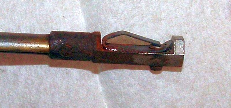

Maybe a better way to phrase it : "It's not supposed to fall out". I've seen a lot of them that do ...
Here's one that didn't

trrdster2000
Randell, it's amazing that you are always Johnny on the spot with photos no one else takes the time to show.
Just a thank you for all the help you give.
Wayne
TR3driver
Great Pumpkin - R.I.P
It's kind of fun, actually, at least compared to what I _should_ be doing. I've been doing some repair work on the garage, which means moving all sorts of parts around; and that choke cable kind of jumped out at me.
