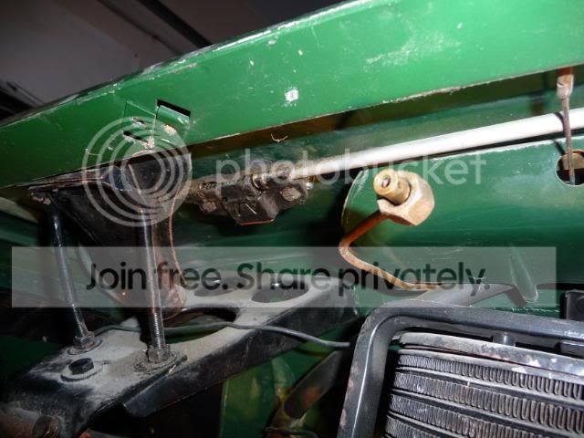

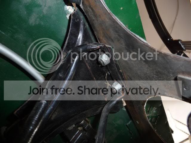

Hi Tink,
Looks like you solved the problem, Here are a couple pics of mine before I disassembled
Cheers,
M. Pied Lourd
Tinkerman
Tinkerman
Thanks for the pics Pied, they really helped!

Hi all does anyone know if the dash mounting studs in Pied’s picture are threaded or welded in. I have a broken one and before I try to unscrew it I thought I would ask.
steve
M_Pied_Lourd
sp, are you talking about the mounting point at the top behind the dash?
Cheers
M. Pied Lourd
TR3driver
Great Pumpkin - R.I.P
I believe they are welded. You could probably replace one by riveting in a captive nut and threading a stud (or bolt) into it, though.
