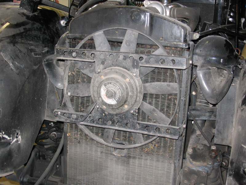

M_Pied_Lourd
Craig,
Here is a pic of the fan. It is a 12 inch fan and as you can see, It just blocks the crank hole on the bottom. I think that 10 inch will be close.....but you might need to go as small as an 8. I am not sure how effective an 8 inch fan will be.....
Yes, the rad is bent!
Cheers,
M. Pied Lourd

M_Pied_Lourd said:
...Here is a pic of the fan. It is a 12 inch fan and as you can see, It just blocks the crank hole on the bottom...
That is the fan I use to supplement the stock fan and I can still use the crank.
I cut away a tiny bit of the plastic grille on the fan just in front of the crank hole. If a fan blade is in the way gently inserting the crank pushes it aside.
