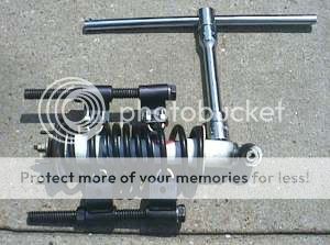

Anybody know who makes a a spring compressor that will fit a Spit? All the ones I've tried are too big to fit in between the coils.

M. Pied, Spits have coilover shocks.
Jody, I have the Harbor Freight ones and they fit after some grinding but I found them scary and dangerous. BTW my first car was a 51 Champion that I bought for 40$
Andrew Mace
I doubt internal spring compressors would work on a Spitfire. In an ideal world, you would have a mechanic friend with a "Tokico Cartridge Changer" as I do. Apparently it's a pretty scarce item; I often scan eBay and Google and never seem to come up with one. These have "jaws" that span the coils nicely, and the principle is the same as that of an older Volvo jack, with a hand crank that takes a number of turns, but those turns can be accomplished with literally only a finger or two. Great tool if you can find one!
I agree that they're kinda scary. At my local tire shop they have a nifty wall mounted spring compressor rig. I want to find out who sells those, or make one myself. It was really nice.
Oh, and that 51 champion would be worth ~20k these days. :smile:

These "U" bolts fasten to a coil to eliminate the chance of slipping off.
At $45.00, it's probably worth it for the added safety. https://www.carparts.com/PERFORMANCE-TOOL-STRUT-COIL-SPRING-COMPRESSOR-SET/GP_2017924_N__10618.car
pjsmetana
JodyFKerr said:
eejay56 said:
Harbor Freight ones... I found them scary and dangerous
I agree that they're kinda scary...
I'll agree to that too... all they use are these little hook looking pieces that feel like they could slide off and kill you at any second.
