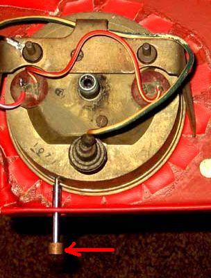

Does anyone know where I might get (buy, beg, borrow, steal) one of these reset thingies?

I couldn't find a source for them, so I wound up making a few. I gave my extras away, so I don't have any left. But, here's a thread that tells you how I made the odometer reset knobs.
BTW, the picture posted by the OP is my dash with one of the reset knobs I made. :cheers:
One more thing, there are two different lengths on the shafts depending on which speedo you have. I believe the ones I made are the longer ones, as you can see how far it sticks down under the dash. So, you can use a long one where a short one will go, but not the other way around.
Edit: Be sure to check up inside the speedo where the reset knob attaches to. Most often, the rest knob is missing because the rod in the speedo has broken, allowing the reset knob to drop out. :eeek:

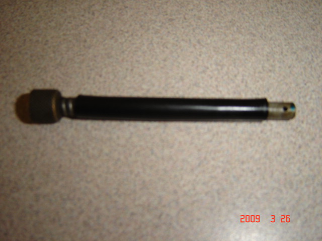

Yea, two lengths---The early one (as shown in the pic) is 2" +/-; the later one (the stamped steel case) is 3" +/- (Smiths used metrics) The problem is the hole in the stem on the speedo side is often torn out, making attachment an additional problem.. If you make your own be sure your new knob is small enough to fit thru the hole in the horizontal dash brace.

Would you like this one? It measures a little under 3" long.

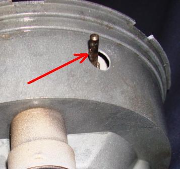

Does anyone have a picture of what the speedo part this goes into looks like. I am worried mine is broken off where the cotter pin goes through it.
TR4nut
Looking at the picture, I bet Adrio sees the same problem on his speedo that I've seen on numerous ones (including a couple I have) - that stem breaks right at the hole for attaching the extension. Haven't figured out what to do about it yet, possibly a small set screw arrangement to tighten down to the remaining shaft.

You are right. Both my speedos are broken right where the pin would go. That was my suspicion but never had any way to confirm it. Now I have to come up with both an extension and a way to attach it to the broken bit. I lived with it for 25 years so there is no big rush on this one.
