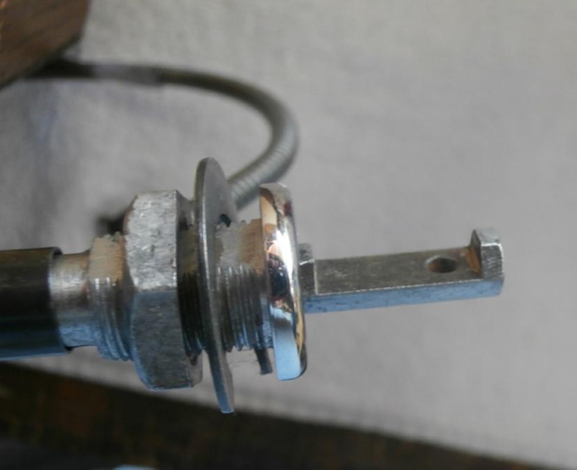

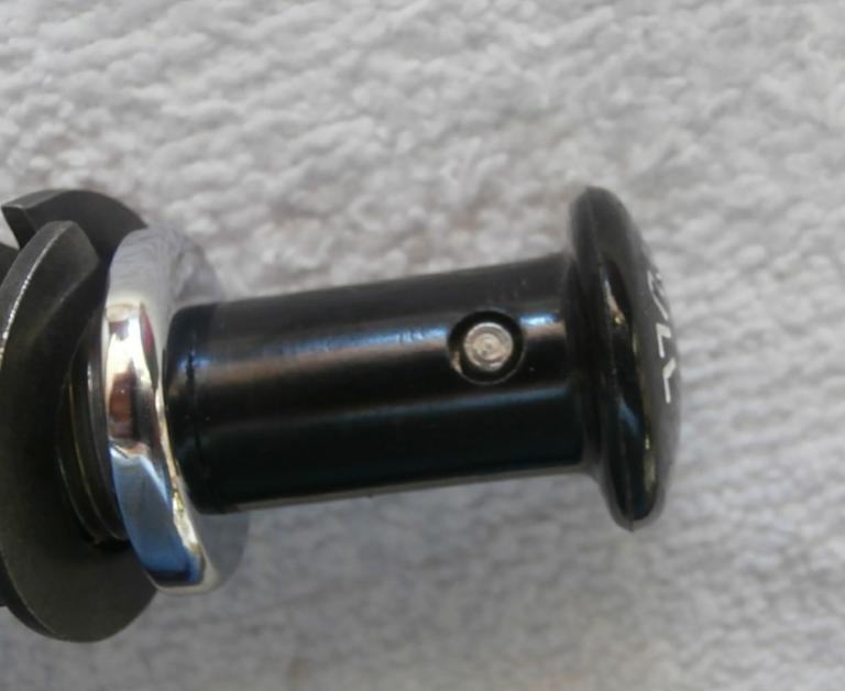

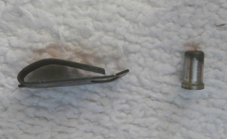

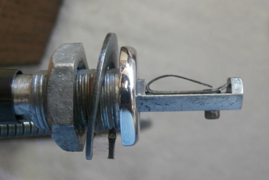

Altho I'm not familiar with all parts on the TR3B, I've never seen a sidescreen choke with a set screw.
Everything I've seen is the style shown in the photos.

The replica choke assemblies offered by the known suppliers have that style spring, they don't offer the spring by itself. To my knowledge, no one supplies them. If you find a source, please let me know. I doesn't make sense to buy a whole new choke assembly just for the spring. You might fine a used push-pull switch with the spring intact. (That would also have the little pin as well) As a last resort, the set screw idea isn't a bad alternative. Fill the hole in the knob with JB weld, drill & tap it with a set screw small enough to fit in the hole that the missing pin sat in. Or tap that hole in the choke handle to fit an available size set screw.
