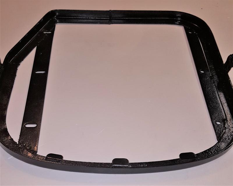

I am reupholstering my seats. Where is the seat back supposed to sit on the bottom seat frame? I was thinking on the three tabs. It doesn't. Sits on the corners. See attached pic. Neither seat back sits very well on its bottom frame. Is that normal? Do folks add rubber or other type bumpers? Am I making sense?

The seat bottoms sit on the bottom flange of the seat frame. The 3 tabs are the support the bottom of the seat back. Sometimes it is necessary to bend the tabs up or down to get them to contact the bottom of the seat back.

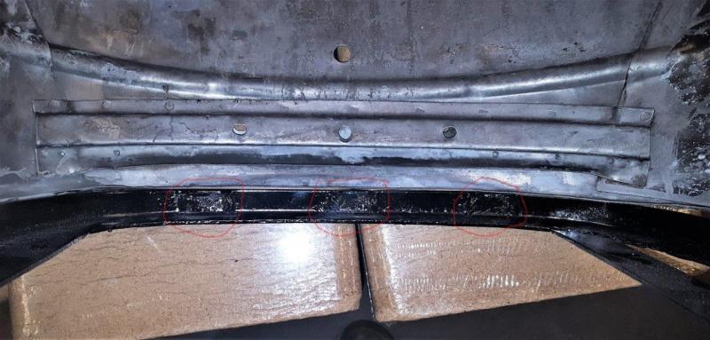

I bent the bottom frame tabs up a little. One needs to be welded or brazed, as it's broken loose. I also bent the bottom of the back rest edge down a little to meet the tabs. I'm not fully confident that the thin sheet metal will stay put and not bend back. Not sure how to reinforce as the leather clips have to fit over. Ideas on that? See attached
I also notice that one of the holes that the seat back pivots go through is oblong. I'll need to fix that.

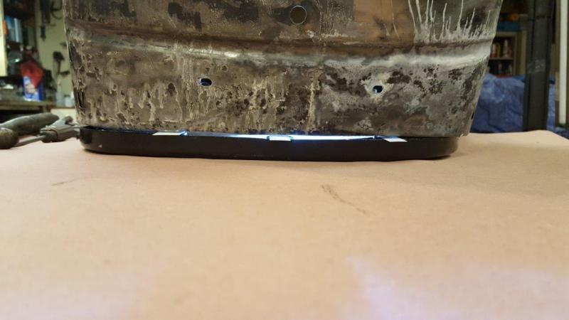

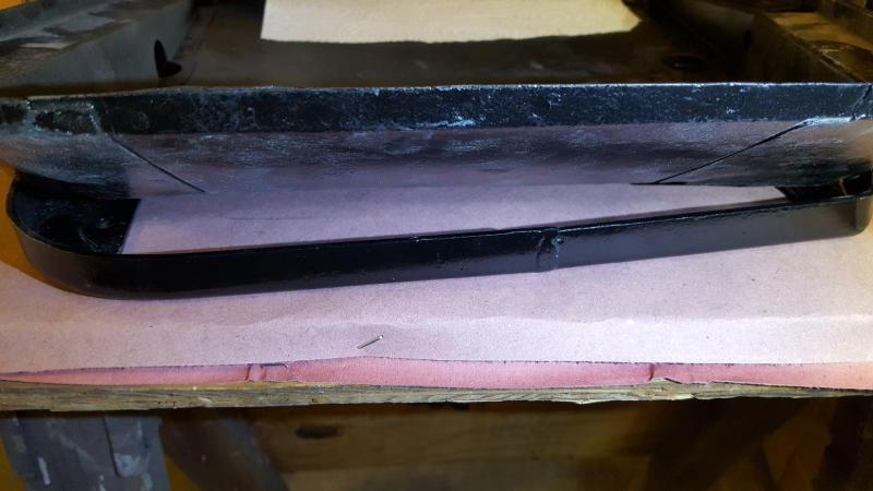

The attached pic of the AHSPares seat diagram confirm that I have the correct parts.
The 3 pieces don't fit well. Look at seat pan. It doesn't drop down into the bottom frame.
I checked out the other seat that hasn't been taken apart yet. The fit is even worse.
I guess I'll have to modify all to make it all fit the best that it will. Am I the only one to find this problem?

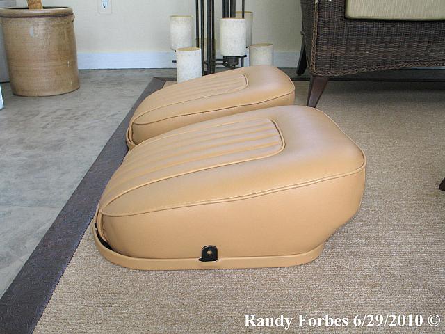

Look how nicely Randy's seats fit together. Mine won't fit that nice even before adding the thickness of leather.
