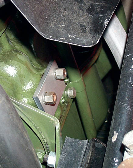

That fuel-pump blanking plate is pretty easy to seal--if you have leaks around it, probably the plate is not flat. I made mine out of 1/4" aluminum stock, and I use ordinary 0.010" paper gasket material, no sealer. It doesn't leak at all.
