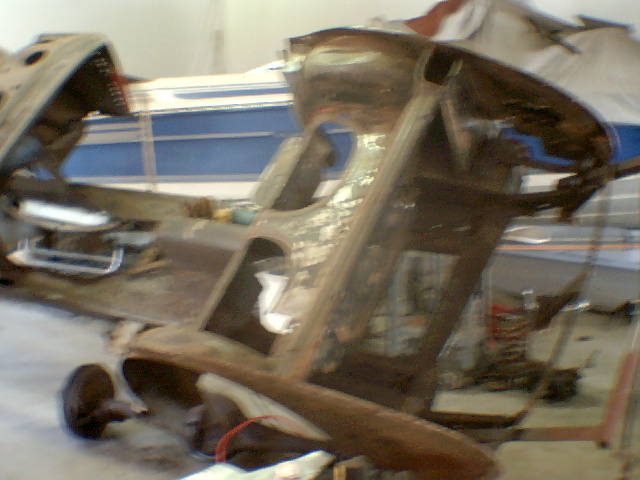

LanceLyon
Whit,
Sandblasting, unless you are talking about small parts that can be done in a cabinet, is not a casual exercise. My car is a full body-off restoration project. Sand will get everywhere: inside panels, behind trim, into moving parts etc. if you were to try to use the technique on anything but a completely striped car.
I am blasting outside with a 20-gallon tank compressor and a Harbor Freight 40 lb pressurized sandblaster. The volume of air produced at varying pressures is the way they are rated. Mine will produce 7 Cubic feet per minute at 90 PSI and is actually pretty light for the use I am putting it to. A better job could be done with at least twice that volume, but there is always the cost-benefit ratio to look at!
Good luck with your project. I'm going to try the solvent approach tonight and see how fast it goes, and then blast the surface to see if it does the job.
Thanks for everyone's input!
Lance

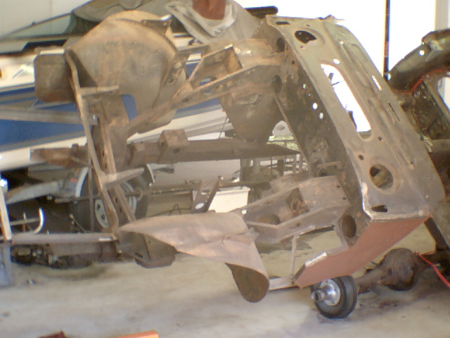

LanceLyon
Well, I tried a couple of solvents, including Laquer thinner and white gas, as well as a wire wheel on my grinder. The wire wheel was by far the fastest as well as the cleanest for removing the old adhesive. When I am done with that I will then go ahead and sandblast the rest of the paint and any rust off that remains. Thanks for everyones input into the process!

whit_iii
Member
I was going to ask you to include a picture and now I noticed that you did. I figured as much regarding how you stripped the car first as the books I have read state that one needs to be very careful when sand blasting. I am trying to do the same so it is nice to have a baseline.
Thanks for the picture and advice as it definitely helps.
