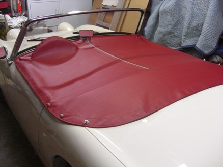

The "long" tonneau cover attached to the mounting brackets where the top attaches at the back. The "short" tonneau attached to the sheet metal right behind the cockpit. If your car already has the snaps for the top, they the long one will fit without adding any new hardware to the car. If you have hardware already installed for the short tonneau, then should probably stick with the shorty. I have heard the long version can whip up and down in the wind and damage the paint behind the passenger space. I have not seen this in my car with the long version.
This tonneau is from AH Spares, special order color to match interior.
Scott in CA

I think they (VB and Moss) are both selling units made by Robbins.

I like the looks of the small one!
