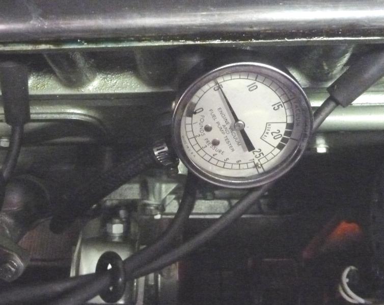

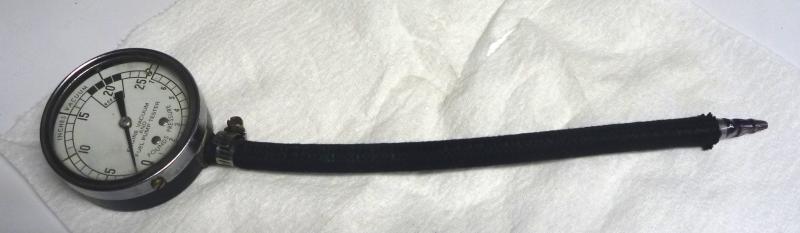

Their experts say you want 1 - 3 inches of mercury suction from your valve. They describe measuring with a vacuum gauge in the dipstick tube. I think I'm getting around 3" because my needle starts around 2".

My car is down for an oil change, pan swap and other maintenance--I'll try to measure when she's running again. I know I can hold my hand over the oil filler hole and feel suction at idle. My PCV kit came from BCS. I'd expect to get less than 5in if there was a filtered air source.
