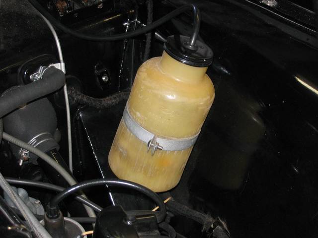

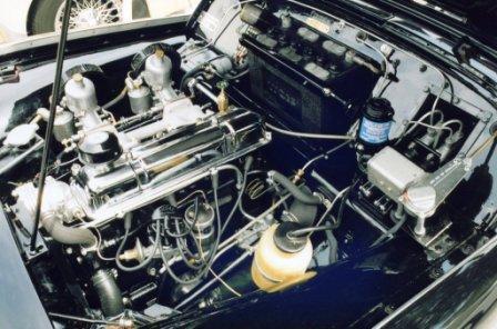

Some one asked for info regarding the bottle shown above. It the plastic reservoir jar for the liquid for the Trafalgar windscreen washers. The other type was produced by Tudor with a clear glass bottle. It was installed from when I took delivery of my 1958 TR3A brand new in May 1958.

Looks just like the washer bottle on my 73 TR6 ... not much change over the years!
