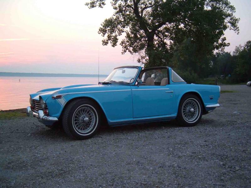

My '67 TR4a IRS sits too high - she has stock front springs and TR6 rear springs with newly re-bushed suspension using poly bushings.
This is the stance I want to get to:
Anyone have experience with a specific vendor springs to get there? I have Goodparts springs on my TR6 and they are a bit more firm that I am looking for, and not sure they would work well with the lighter TR4a.

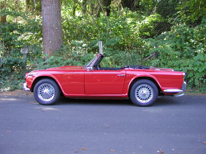

Here is my car on springs from BPNW. Perhaps a bit higher than the one you are showing, but much better than the springs I got from TRF. All of this was 10-15 years ago, though, so my info may be out of date.
T
tdskip
Hi Darrell - thanks for the picture. I have the adjustable trailing arms, so maybe the BPNW springs with the trailing arm adjustment and flipping the front wishbones upside down might get me there?

Well, best of luck. It started for me with a saggy rear end.
This is with the first set of short heavy springs from TRF.
Nice huh.
And currently with the exchanged TRF Competition / Goodparts 1" lower stiffer springs and no spacers.
Rear seems pretty good for me and a tad under stock height. Front suffers from knock knee's and looks low with my bike tires. I'm putting in a small spacer one of these days to raise it 1/2" or so to what will be about stock height. The front is closer to what your looking for, don't know why the rear didn't sit down more.
