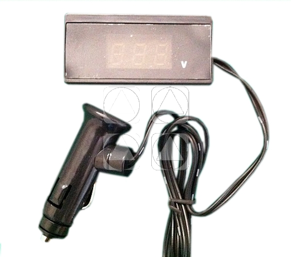

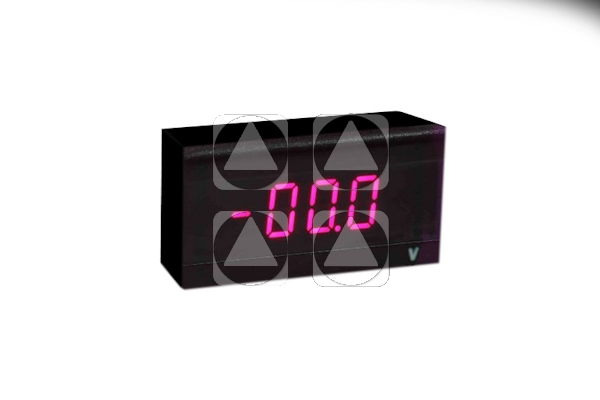

andrea
Fast system to add a voltmeter. a Chinese digital one that costs less than 7$ - easy to fit if you have a socket for cigarette 20110801105209-digital2.JPG20110801105208-digital.jpg similar in USA probably you can find on e-bay https://www.ebay.com/itm/New-Mini-C...or-12V-Black-Red-Digital-Screen-/290963492854
https://www.ebay.com/itm/Digital-LE...ar-Battery-Tester-Gauge-12V-24V-/181162762736
https://www.ebay.com/bhp/digital-voltmeter-4digit -or on web
