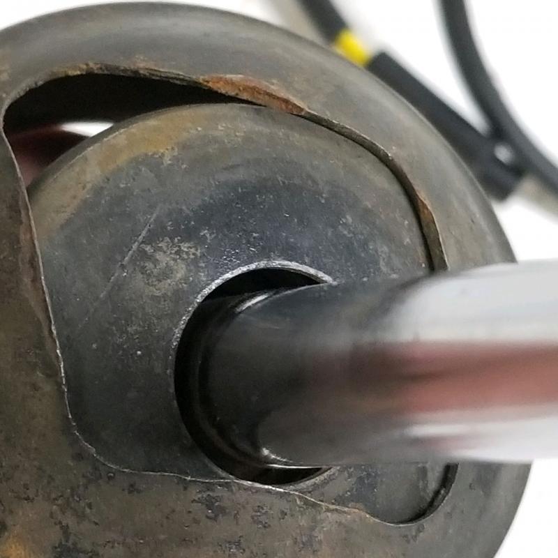

The gear lever that came with my new OD transmission is difficult to move into some gears positions. Transmission is not n the car yet. I am not going to use this cap on my car.
I noticed that the inner cap is catching on the outer cover as you try to move into some gear positions. In the photo you can see the wear on the outer cover. Could this be the issue?
David

End play would allow the shifter to move, but not fully engage the gear. So not likely your problem. Could be a jammed 3/4 slider...but that would be rare. My money is still in the top cover.
