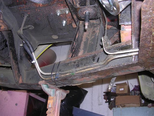

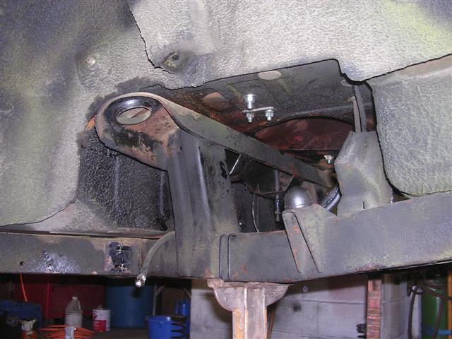

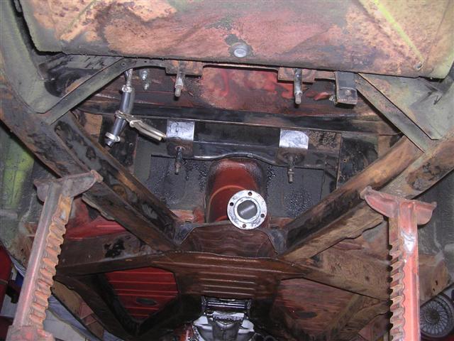

It connects to a metal line at the left rear of the car. The vent line should be beside it on the right. These pictures will show where the two lines are with everything else out of there.
20lbs psi is plenty. Remove the cap and have some listen for the gurgling sound in the tank as you slowly apply air to it.
And don't discount one of those lines back there being weak and collapsing either.
