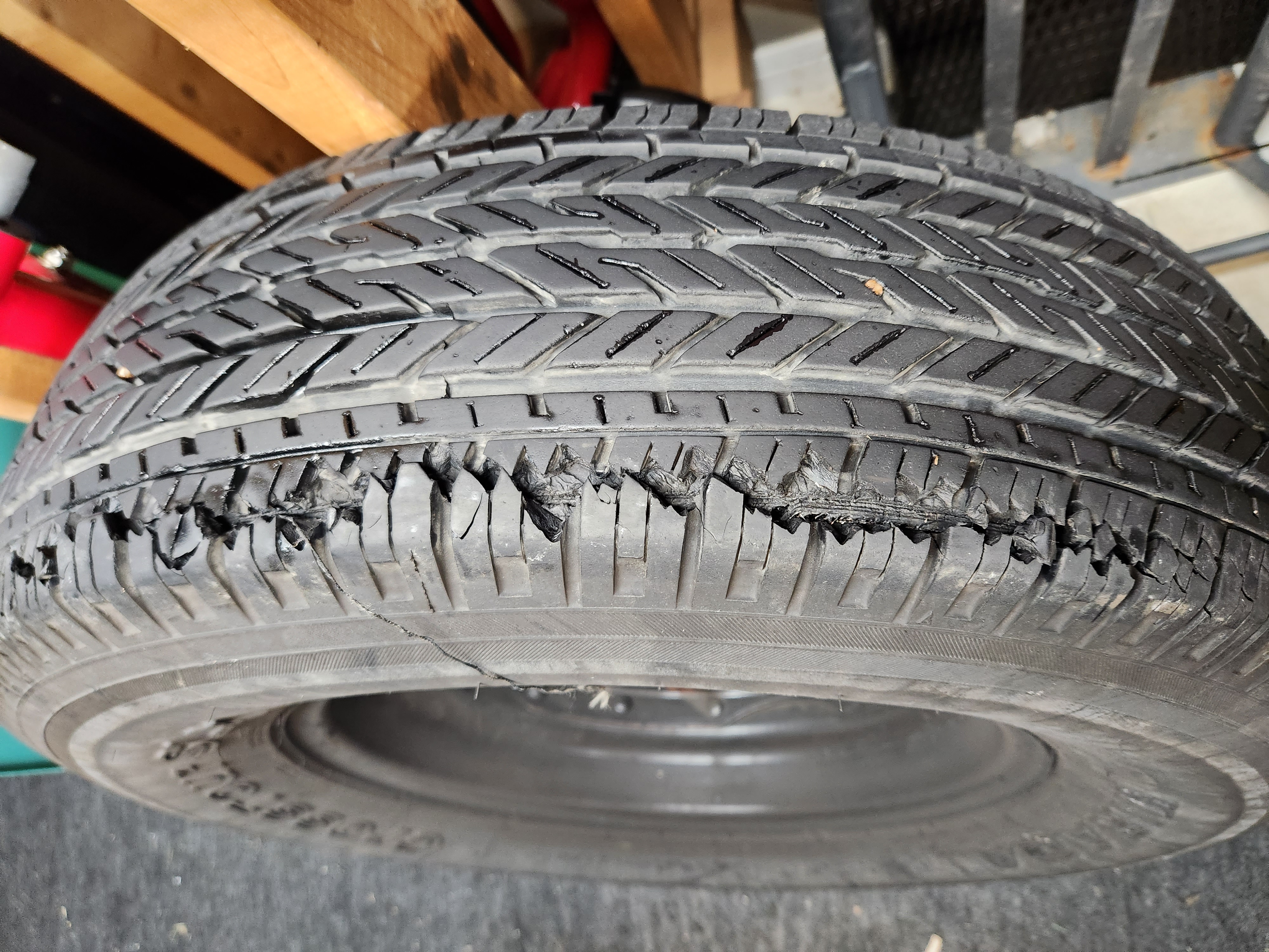

I was warned in 2021 that the tires on my Bentley were 9 years old. I began shopping for new ones but never pulled the trigger. Driving to a show in December 2022 the car didn't ride smoothly; I assumed from flat-spotted tires. On the way home it began shimmying up and down and lurching side to side. I asked my wife to drive it around the block so I could watch... and I saw the left front tire trying to come off the rim.
This is how it looked after I pulled out the valve stem core to let the air out (as quickly as I could -- it looked ready to blow up in my face). The cambered tread is not an optical illusion -- the tread is actually sliding off the carcass towards the outer sidewall. It looked even worse inflated. You can also see a line running from the split across the inner sidewall (12:00 to 9:00 in the photo), that is a nylon cord that came loose.
Thanking my lucky stars that it was a local show. I had scheduled to drive a wedding couple 60 miles away the following weekend!
