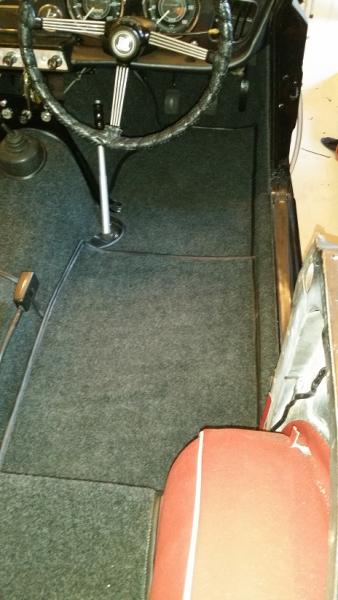

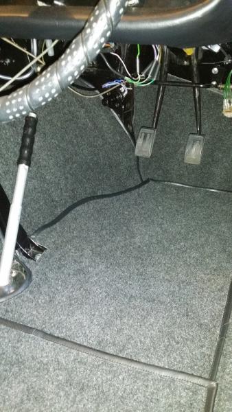

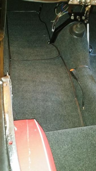

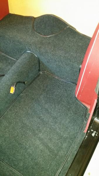

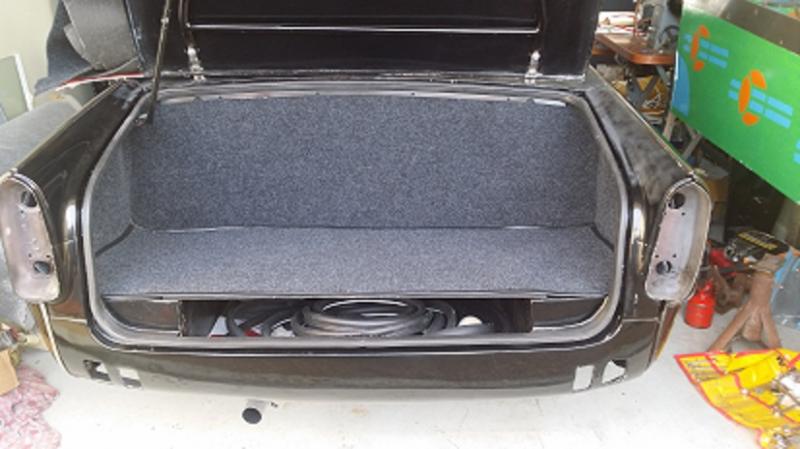

I you're thinking about making up your own carpet here's a brief story about mine.
I decided to have a go at doing my own carpets for my TR4.
My old ones were extremely tatty very thin loop pile carpets that had worn very badly.
I went along and purchased gel backed synthetic outdoor cut pile carpet that looked quite finely piled, not course looking at all.
I couldn't find black wool carpet in New Zealand for a half decent price, it would've been cheaper to buy from TRF.
I paid US$94 for 3.5 x 2M length excluding the vinyl edging which was about US$20.
I glued black Dynamat type material onto my floors.
I used the old carpet as a template for my new carpet, that was a big mistake as it didn't fit because the new carpet was thicker and harder to hide the bad fit.
After cutting the carpet I realised that I should have cut my own templates.
So I got a whole lot of newspaper and made my own, newspaper is too flimsy but works at a pinch.
I was lucky as the carpet pieces were too big and could be further cut to a much closer fit.
My friend then spent a few hours edging the pieces for me.
The carpet is secured by velcro, glue, gravity, the seat belt stalks and soon the seat rails.
I'm quite pleased at how it turned out.
One of the major reasons I did my own was the fear of buying a set to find that it was not a good fit.
I'll probably buy another 1 x 2M length of carpet as a spare incase of disaster.

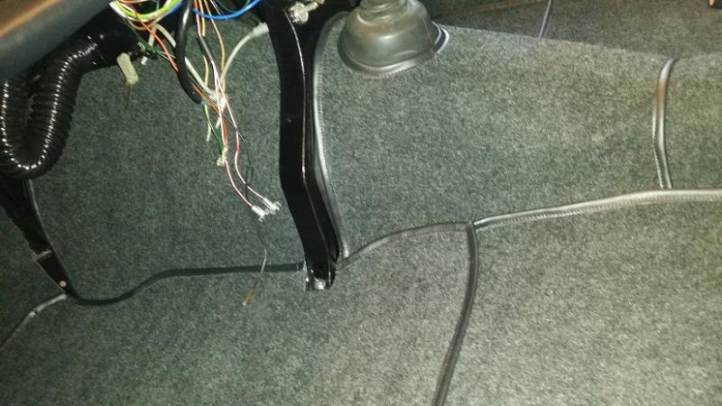

One advantage of making my own carpets was the installation of the scuttle support.
I tried putting it in on top of the carpet and dynamat but found the the radio plate wouldn't fit.
I then read that some people gently jackup the dash with a piece of wood under the dash so as not to damage it.
I was about to do that when I thought what if I cut away the Dyanamat under the support and cut the carpet so that it's around but not under the support.
Woww it fitted without any jacking up.
This solution might not be to everyone's satisfaction but I'm very happy with it.
I also trimmed the carpet around the rubber handbrake thingy instead of covering it.
