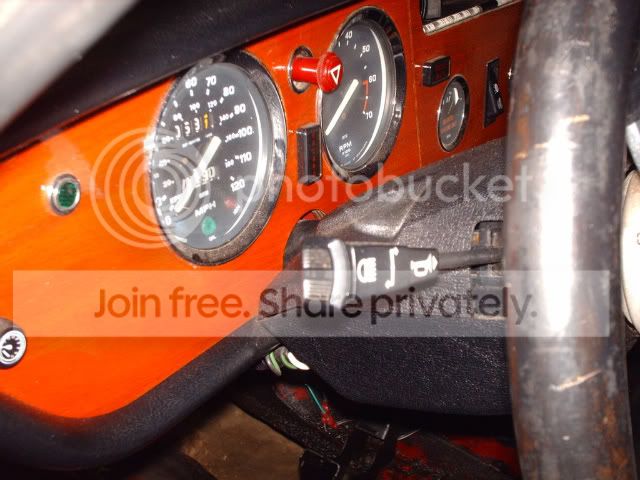

When you say "cleaned the paint off the gauge rims and they are nice pretty chrome", do you mean the flat black on the inner side of the rims? My 73 TR6 has gauge rims which are chrome on the outer side of the rim and painted on the inside. I would love the look even more if I could get the black paint off without damaging what was underneath. Any pics? What did you use to remove the flat black?
Thanks.
eejay56
It's still hard to see in this but yes in the earlier pics you can see the chipped and gross flat black paint. I used a rag with some lacquer thinner (very carefully because the dash was done and reinstalled) and this nice chrome appeared.
