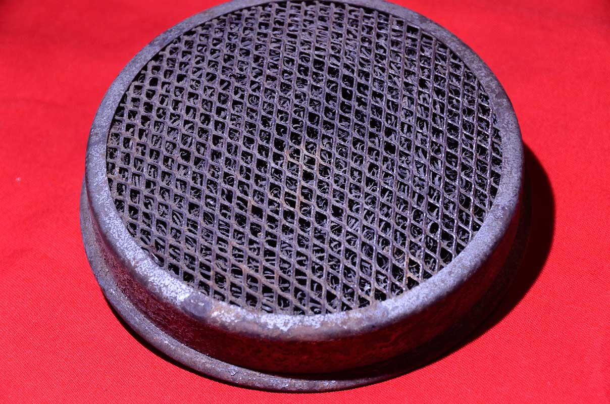

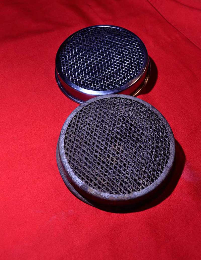

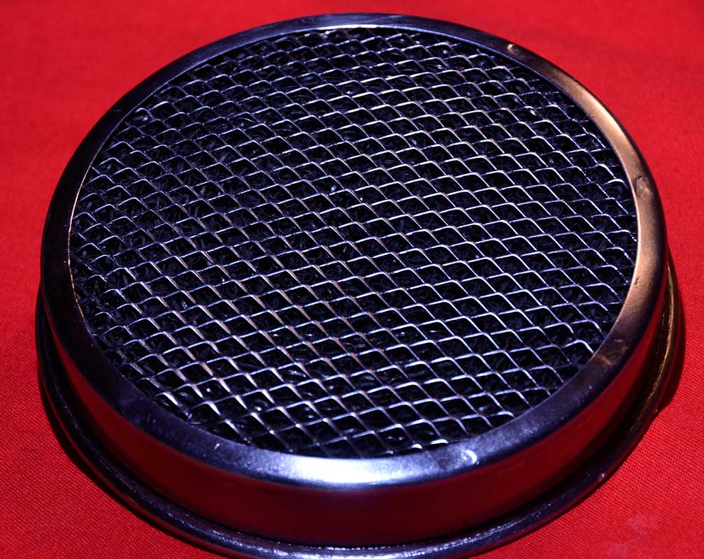

I was sitting around waiting for the new server to come on line, and I got to thinking. How shiny could I get steel to polish up? I had some real grotty air cleaners, so I sanded one then buffed it with black emery, then finished with white rouge. After it was polished, I clear coated it. Granted, it's not quite as shiny as chrome, but it's not bad. If I go to brown Tripoli to finish, it will probably come a little brighter. Not bad for an hour and a half of work and almost $0. Photos show before and after.

Unfortunately it will probably rust under the clear.

Then we'll buy new chromed ones. :thumbsup:
Rut
Excellent job...time for me to break out my buffer!

Eventually, I've done things like this before and they stayed nice for a long time. I just did the steering wheel on the 6 like this.

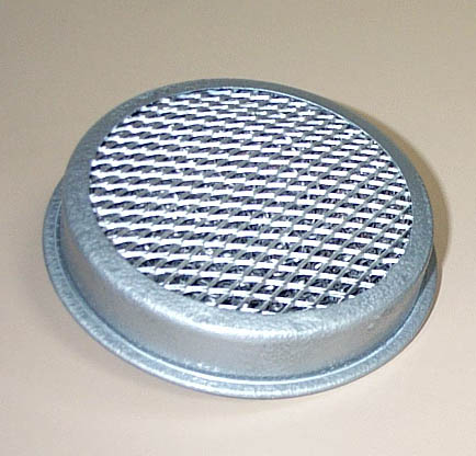

Another option for the air filters is good ol' Rustoleum gray hammertone, from a spray can. It looks surprisingly good. I did mine with this, then painted the screen with aluminum paint.

Actually, I didn't spray paint into the filter. I masked it off while doing the outside. Then painted the aluminum paint on the screen with a brush. (Sorry, I realize that wasn't clear!) Still, that Bugeye air filter is good only for filtering out particles the size of buffalo chips, dead squirrels, fire hydrants, and similar-sized things. I don't think you could plug it up if you tried.
