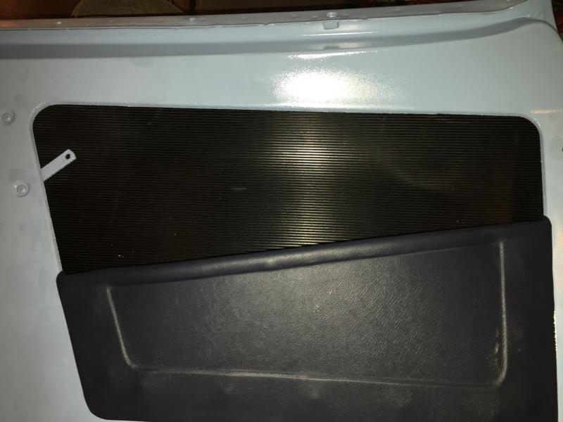

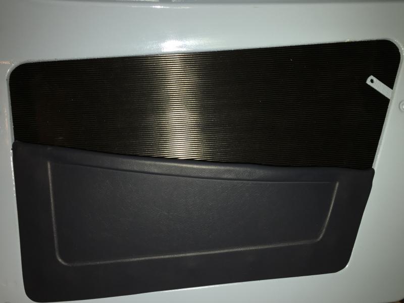

Thanks, cleaned and roughed up with 60 grit. I used a Permatex brand adhesive made for this kind of application...not contact cement and it lets you reposition the rubber before it dries.
Rut

AN5Sprite
Perhaps a point of debate.... :fat: but, ain't no way that's the proper handle placement... NO WAY! (not criticism, just looking to spark debate)

Good eye guys! I reversed the door handles so they would open pulling them up vs pushing down...personal preference.
