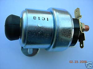

Does the engine fire when you squirt starting fluid into the carb inlets, turn on the ignition, and try to start? (There's a starter button on the back side of the solenoid relay.) Similar to this:
