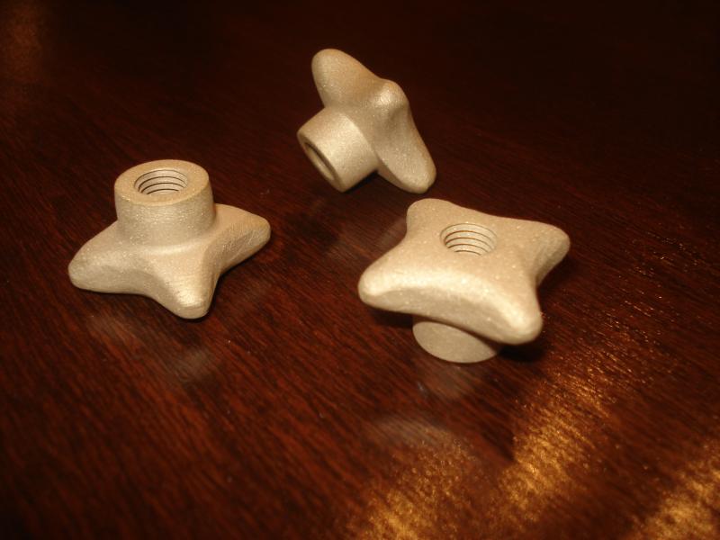

Does it have a gallery head and are the hand screw nuts that hold the side screens if they are still on the car four pointed square-ish shaped ?
Look at the bows for the top, and the interior panels in the rear. I've been looking for a pair of the star nuts for years for my windows!
That's the little devils right there��
